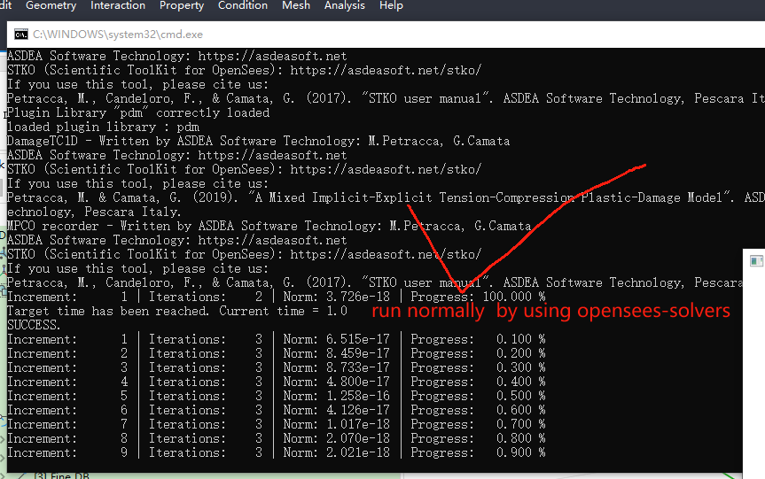

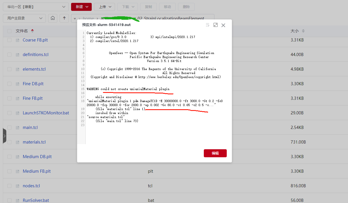

When using DamageTC1D material, the material runs properly in OPenSees-Solvers. However, it doesn't work normally in the Linux version. The Linux version is compiled using github-opensees, is there a solution method?
For shear wall fiber damage, when Layershell is used, the NDmaterials ASDConcrete,and DamageTC1D can be used. However, for pile fiber section, concrete only DamageTC1D can show fiber damage with shear force and bending moment.

Unfortunately, the DamageTC3D and DamageTC1D are available as plugins but only on Windows and they are not in the official OpenSees repo.
That's why we started integrating them into their new versions ASDConcrete3D and ASDConcrete1D. However, the ASDConcrete1D is not available yet. We will add it shortly. In the meatine you should go with another 1D concrete material

You can use any other Concrete uniaxial material but none of them has the damage output

Anyway, with the new version released yesterday the ASDConcrete1D is available
