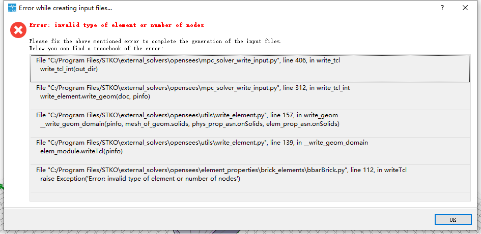

First of all, thank you very much for your answer. I have made some modifications, but there seem to be some problems during the operation. I just came into contact with this software and I don't know how to solve it. Can you help me see where the error is? Thank you very much!

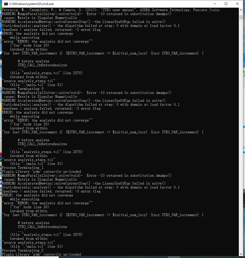

Re: analyse
Post by STKO Team » Mon Oct 30, 2023 9:25 am
You attached only an image... not the file.
However, from the error: it says that your matrix is singular. You should make sure your model is properly constrained

Re: analyse
Post by kesavapraba » Tue Nov 07, 2023 12:24 pm
I've identified some inconsistencies in your model:
[1] The lateral ties lack assigned element properties (dispBeamColumn).
[2] Please choose the edges (excluding vertices) to assign interaction, physical, and element properties to line objects.
I've included the updated and functional model in the attachment. Feel free to reach out if you require additional assistance.
