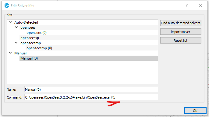

The Command string for your 2 manual solvers are missing the #1 keyword.
The #1 keyword is used as a place-holder that STKO will replace with the filename of the TCL script to run.
There is another keyword, #2, that instead is used a place-holder for the number of processor. This is of course only useful with OpenSeesSP and OpenSeesMP (parallel versions).

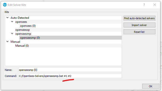

Please change the Command string adding the #1 keyword as in this example:
Instead, if you want to use parallel versions of OpenSees you can also add the #2 keyword as in my OpenSeesMP batch file:
