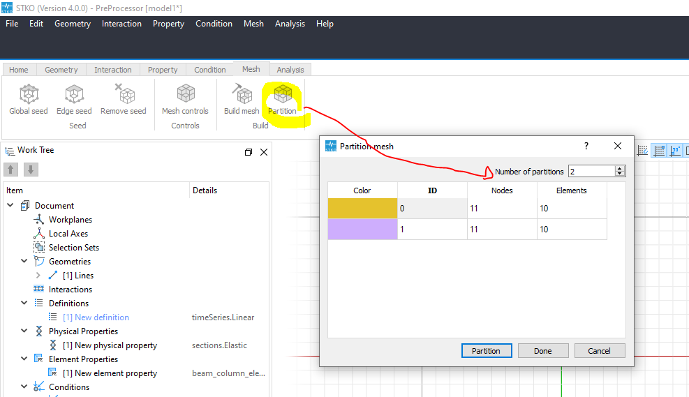

Re: Parallel analysis
Hi, are you sure that you partitioned the model in addition to choosing openseemp solver, changing analysis settings with parallel solvers (like Mumps), and parallel numberers?
- Capture.PNG (46.6 KiB) Viewed 472 times
