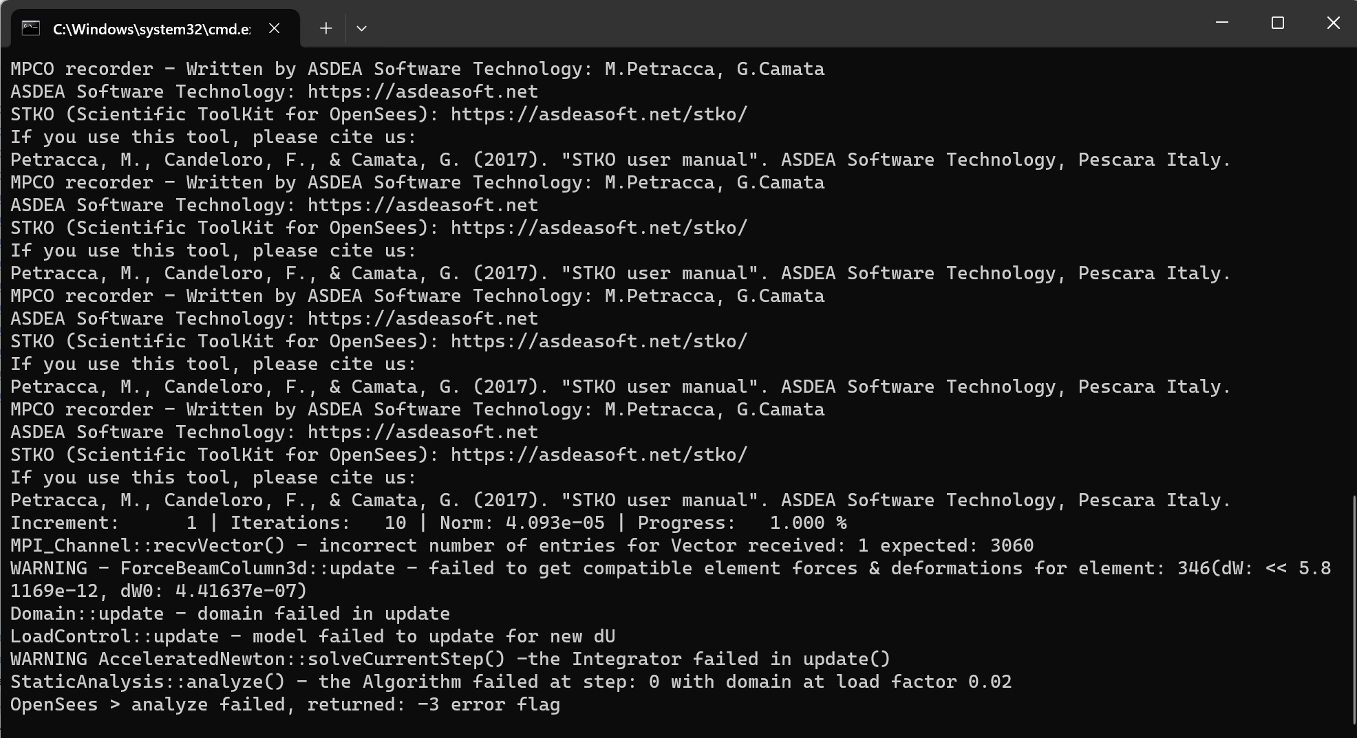

MpI Channel:;recvVectorO- incorrectnumber of entries for Vector received: 1 expected: 3060
Dear STKO team
When I try to model masonry by equivalent frame approaches, the following error occurred while running my model. Can you tell me how to fix it?

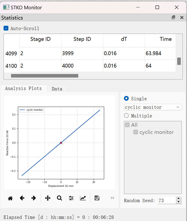

Dear STKO team, I find I defined wrong parameters for pinching4 material. The model can run normally after inputting right parameters. But the hysteretic curve as following picture is still wrong.kesavapraba wrote: ↑Mon Nov 13, 2023 10:18 pmHi, Can you please share a minimal model that shows this issue? We will look into that error.

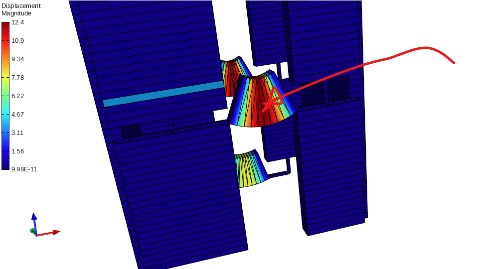

Hi, there seems to be some issues with spandrel connectivity with the rest of the elements - Spandrel deforms a lot even before starting cyclic loading as seen in the attached figure below. Can you recheck how you discretized the wall and connection between piers and spandrels?
I would also suggest you performing a monotonic loading first with elastic properties of the materials and subsequently progress to cyclic loading with inelastic material properties if displacement pattern is found appropriate.

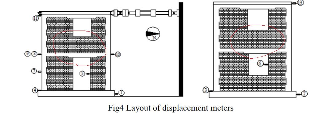

Dear kesavapraba, in fact, there is a problem that troubles me. If there are lintels or slab below the spandrel as the following picture, then how to define the parameters of shear spring for modelling the shear behavior of spandrel.xgx wrote: ↑Wed Nov 15, 2023 12:25 amThank you very much, your advice helps me a lot.kesavapraba wrote: ↑Tue Nov 14, 2023 4:00 pmHi, You might be interested in the following articles. However, please ensure using appropriate material models for capturing the shear responses of piers.
Quagliarini, E., G. Maracchini, and F. Clementi. "Uses and limits of the Equivalent Frame Model on existing unreinforced masonry buildings for assessing their seismic risk: A review." Journal of Building Engineering 10 (2017): 166-182.
Morandini, Chiara, Daniele Malomo, and Andrea Penna. "Equivalent frame discretisation for URM façades with irregular opening layouts." Bulletin of Earthquake Engineering 20, no. 5 (2022): 2589-2618.
Manzini, Carlo Filippo, Paolo Morandi, and Guido Magenes. "SAM-II: development and validation of an EF-based program for seismic pushover analysis of masonry buildings." Bulletin of Earthquake Engineering (2023): 1-49.
- spandrel with lintel or slab.png (147.37 KiB) Viewed 5821 times
Re: MpI Channel:;recvVectorO- incorrectnumber of entries for Vector received: 1 expected: 3060
Dear kesavapraba, thank you very much. After reading the literature you told me, I realized that I had made some mistakes. Now I know how to fix them, thanks for your help.xgx wrote: ↑Wed Nov 15, 2023 12:52 amDear kesavapraba, in fact, there is a problem that troubles me. If there are lintels or slab below the spandrel as the following picture, then how to define the parameters of shear spring for modelling the shear behavior of spandrel.xgx wrote: ↑Wed Nov 15, 2023 12:25 amThank you very much, your advice helps me a lot.kesavapraba wrote: ↑Tue Nov 14, 2023 4:00 pmHi, You might be interested in the following articles. However, please ensure using appropriate material models for capturing the shear responses of piers.
