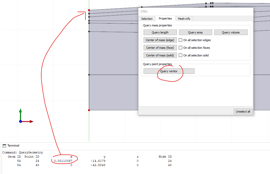

The drawing you did in AutoCAD is not precise.
For example, the left vertical side is not strictly vertical, you can see it by zooming, or by doing a query of the bottom and top vertex position: The Automatic absorbing boundary assumes the sides to be perfectly horizontal or vertical.

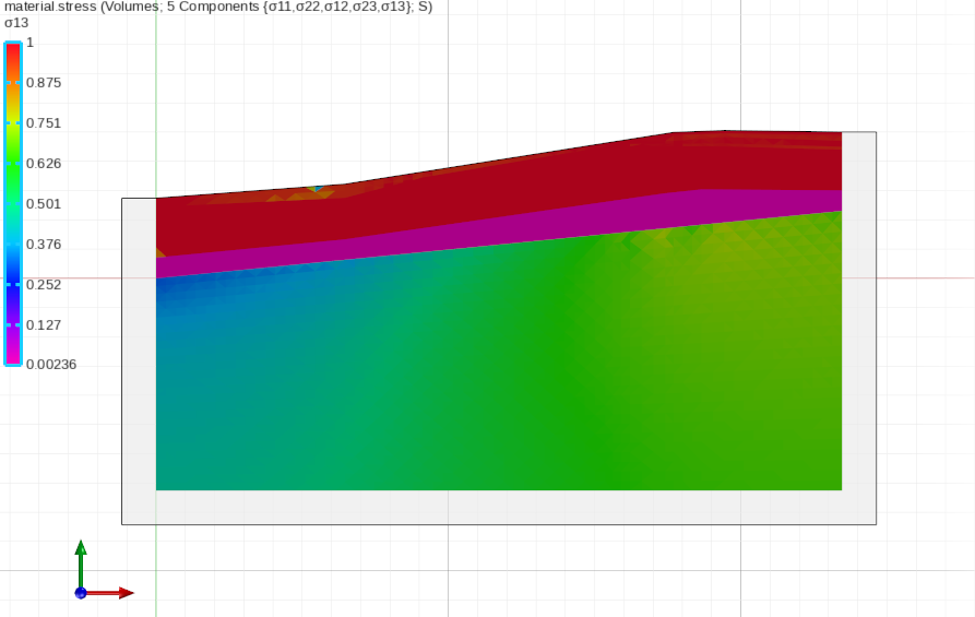

The post-elastic analyses have a very large error tolerance:
a tolerance of 0.01 in NormDispIncr means that you are accepting an error of 1 centimeter (since you are modeling in meters).
Also, the plastic gravity analysis is made transient with a duration of 1 second. It may induce too large accelerations since the change from elastic to plastic happens suddenly.

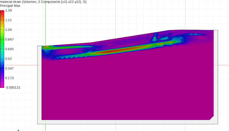

I tried to change the parameters but it will take a lot to converge. It looks like all the upper layers in your model entered a deep nonlinear state already from gravity. Here is the last component of the stress tensor which gives an idea of the level of nonlinearity:
This is the strain localization band, which also shows the level of nonlinearity you are having:
Of course, this sudden change from elastic to plastic generates some spurious accelerations. However, as you increase the time of the gravity analysis (I used 100 seconds), the inertia effects will be lower
Here is my file. play with it and let us know:
