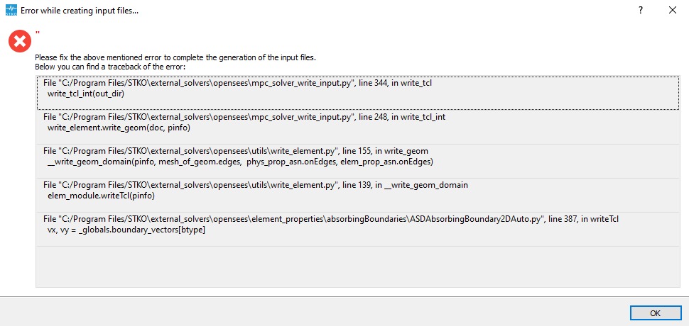

I ran successfully the gravity analysis and now I'm trying to run the dynamic one adding ASDabsorbing Boundaries(2Dauto). I used as imput motion a Ricker Wavelet.
STKO doesn't run the analysis and shows the error window below:
Error window.jpeg (86.59 KiB) Viewed 4554 times
I don't understand how to solve it. I attached the files of the whole model so you can understand what I've done. Can you help me realize what's wrong?

The drawing you did in AutoCAD is not precise.
For example, the left vertical side is not strictly vertical, you can see it by zooming, or by doing a query of the bottom and top vertex position:
The Automatic absorbing boundary assumes the sides to be perfectly horizontal or vertical.

Thank you for your prompt reply and the assistance in solving the analysis problem. I fix the problem and it is working fine.
