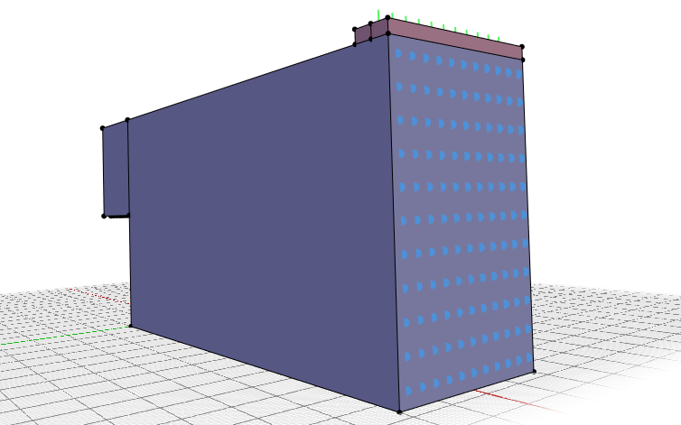

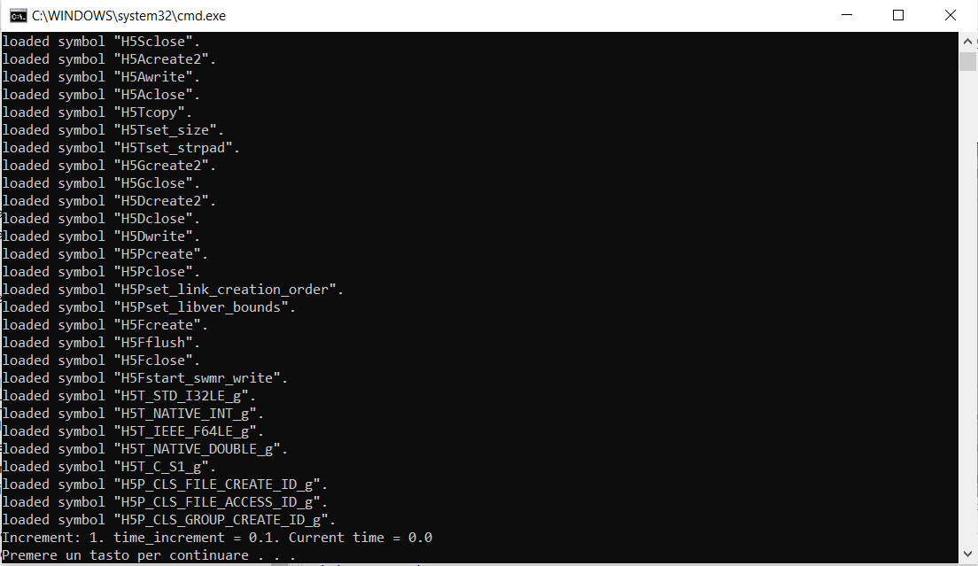

I have been having the following issue concerning the analysis of a Gerber joint, the model has been made by using solid element (geometry and the assigning the nd.materialTC3D), for concrete and solid element (assigning ElasticIsotropic material) for bearing and top plate. The bearing and the plate are linked to the concrete with Interaction - NodeToNode - (or General, mention this as well as it was also tested however with the same output). The plate has an imposed displacement (-z).
For the boundary conditions:
1. The Figure 1 depicts the restrains of the cut face which is defined as a bi-pendulum;
2. Bearing has a restrain in ux, uy, uz as it is shown in Figure 2.
The analysis options and output are shown in Figure 3 and 4.
The problem with the model is that there is MPCO file. This has nothing to do with the possible ‘path missing’ of the OpenSees executable because I have been able to run several examples.

Before the very first result can be plotted on an MPCO recorder, the model seems to have crashed. Send us your file and we can have a look.
