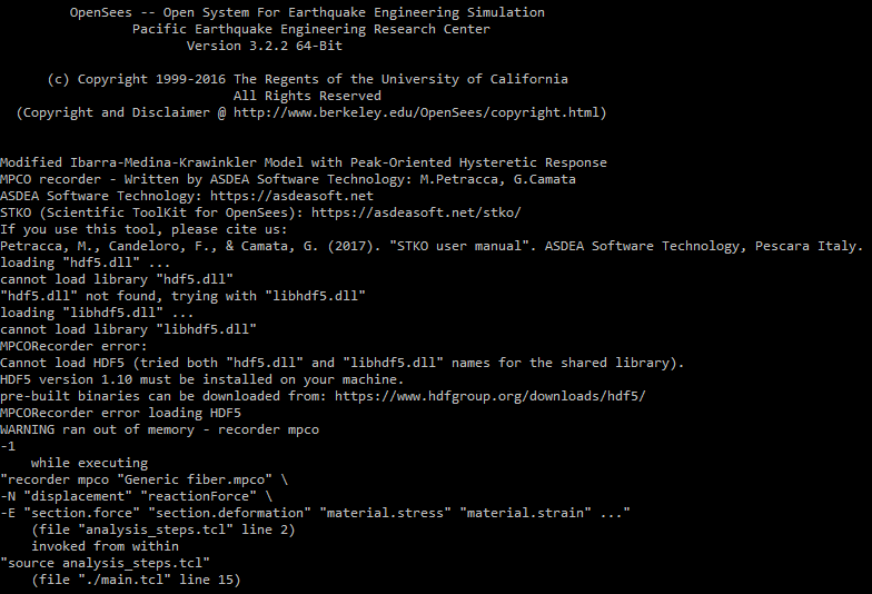

At this point, during the execution of the analysis of any model (also example models at this link https://asdeasoft.net/?stko-example-files), I have this problem (here with a simple example model):
loading "hdf5.dll" ...
cannot load library "hdf5.dll"
"hdf5.dll" not found, trying with "libhdf5.dll"
The "hdf5.dll" file is in the STKO directory and I try also to put it into the opensees.exe directory. I try various solution suggested on the web (install a more updated version of vcredist_x64, create a specific environment variable, download libhdf5.dll file, ...) but always with the same result (↑).
How should I solve this problem?
PS: I'm using the latest version of OpenSees (v3.2.2)
