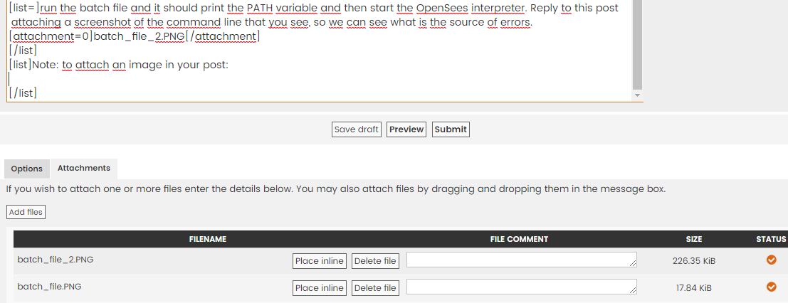

  • Go into "C:\Program Files\STKO\opensees"
  • Edit "C:\Program Files\STKO\opensees\opensees_303.bat" with a text editor (I use Notepad++) with administrator right (Notepad++ > Right Click > Run as Administrator) and comment the first line
  • run the batch file and it should print the PATH variable and then start the OpenSees interpreter. Reply to this post
    attaching a screenshot of the command line that you see, so we can see what is the source of errors.

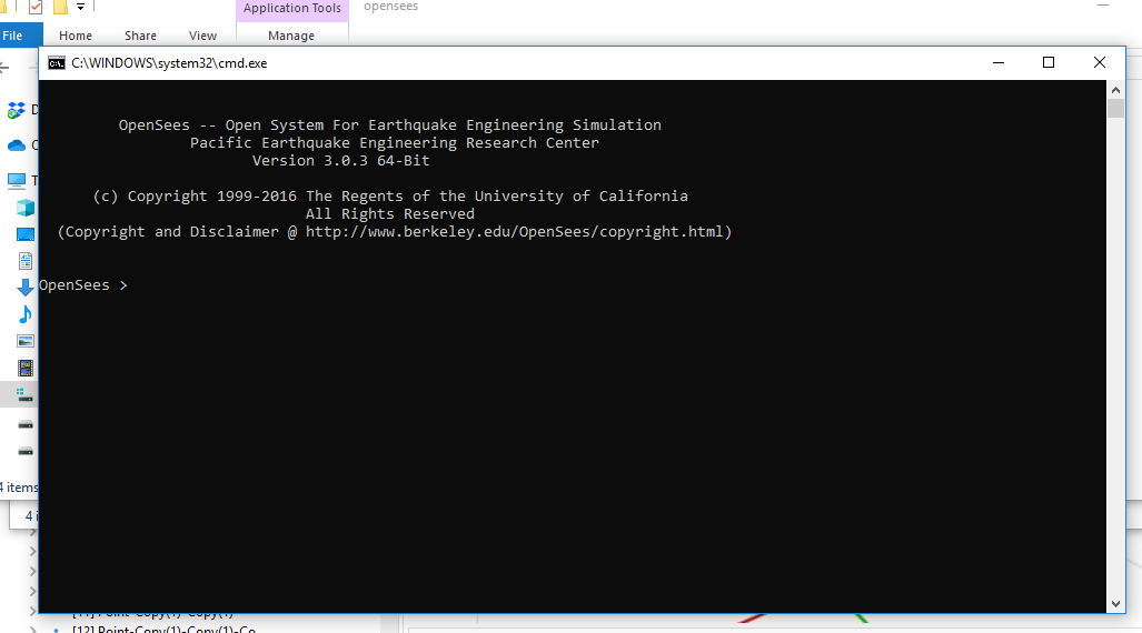

Thank you for your help. Now i will attach the screenshots from my steps and i hope it will help you detect the problem.
  • fig. 1 shows what happens when i run the batch file without any intervention
  • fig. 2 shows the intervention as you suggested
  • fig. 3 shows the response after the intervention

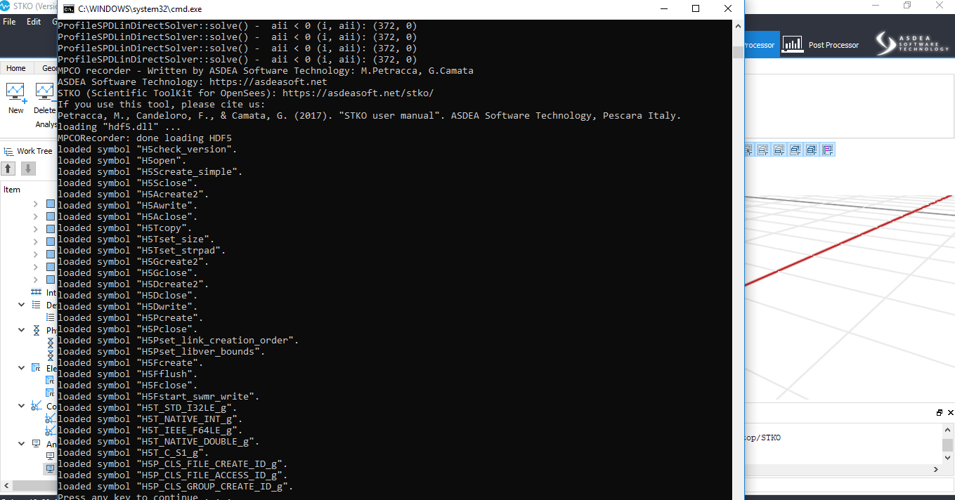

  • fig. 4 shows the response of STKO when i run it with intervention in batch file

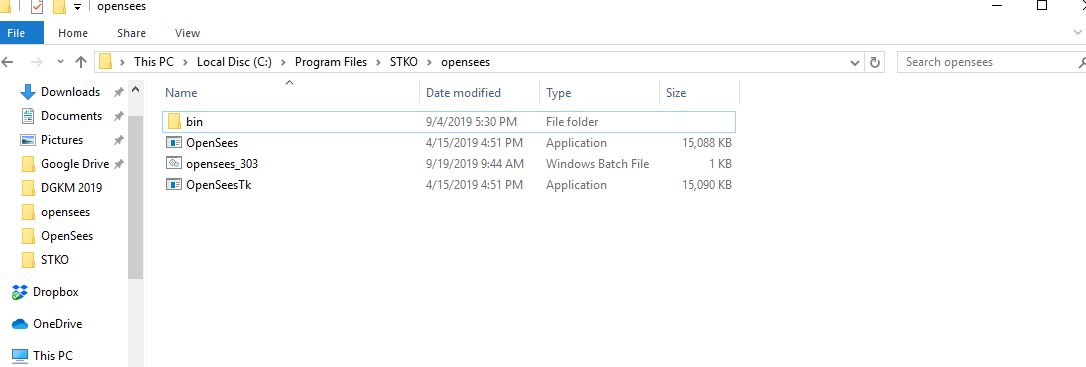

  • fig. 5 shows the original problem, no interventions and not copied opensees.exe in the file directory

This is even stranger than what I expected! From fig.1 and fig.3 I see that if you run the batch file manually inside "C:\Program Files\STKO\opensees" it can find OpenSees.exe, in fact you see the OpenSees interpreter cmd line.
But (fig.4 fig.5) when you run it from STKO, it runs the batch file from the directory where you have the TCL files (in your case "C:\Users\Filip\Desktop\New folder". And in that case it cannot find OpenSees.exe, even if the PATH variable is correctly set as shown in fig.5!
1) Can you confirm that "C:\Program Files\STKO\opensees\OpenSees_303" contains OpenSees.exe?
2) Try to save your model in a directory not on the desktop, and run the analysis (show me the error in the cmd line, if the error is still there)
3) Try to run STKO as administrator and run the analysis (show me the error in the cmd line, if the error is still there)
4) If none of the previous worked, open a cmd line, move into the directory where you have your TCL files ("C:\Users\Filip\Desktop\New folder") and type "opensees_303.bat main.tcl" (show me the error in the cmd line, if the error is still there)

  • fig.1 the STKO folder in Program Files contains the OpenSees.exe file

Found! you have OpenSees.exe in "C:\Program Files\STKO\opensees", while it should be in "C:\Program Files\STKO\opensees\bin\OpenSees_303", because the opensees_303.batch file assumes it is located there.
Since this happened, I think you downloaded STKO without OpenSees, because if you downloaded STKO+OpenSees the OpenSees executable would have been in the right location.
So I assume you are using your own version of OpenSees. That's fine but it is a version prior to 3.0.0, it will not have the "mpco" recorder, and so it will not produce the results of STKO.

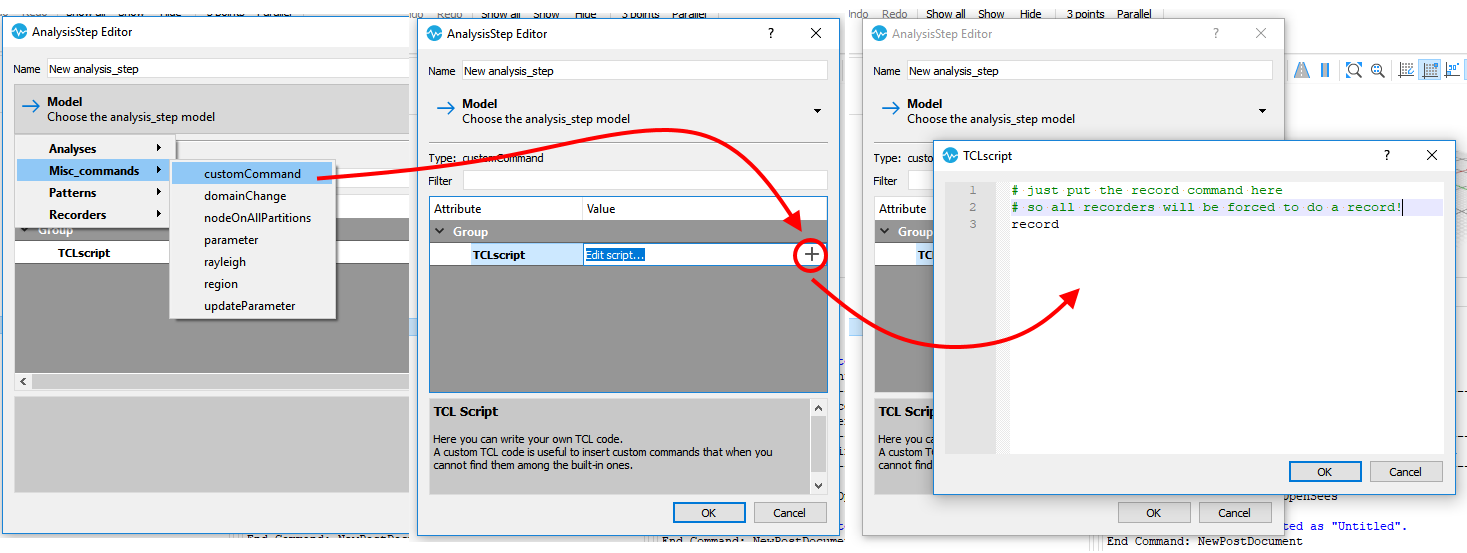

This is enough in 99% of the case, i.e. when you have other analyses after the eigen command. However in this case you only have the eigen command! Unfortunately in OpenSees the "eigen" command does not automatically call the "record" command, which instead is called by "analyze". So whenever you want to compute only the eigen analysis, just create a 3rd analysis step of type "CustomCommand" where you can insert your own TCL code. In this case we just need to put the "record" command
custom command.png (67.73 KiB) Viewed 12272 times
