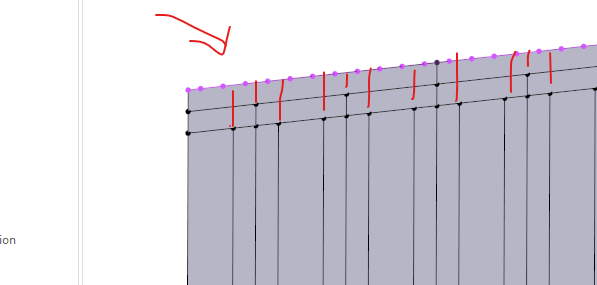

  • Your geometry has some faces that cannot be meshed with structured quad mesh (they have more than 4 edges). If you want to keep it as it is, switch to unstructured triangular mesh, and choose a triangular shell element. Otherwise, cut your geometry to make it suitable for structured quad mesh:
    extra cuts.png (15.81 KiB) Viewed 500 times

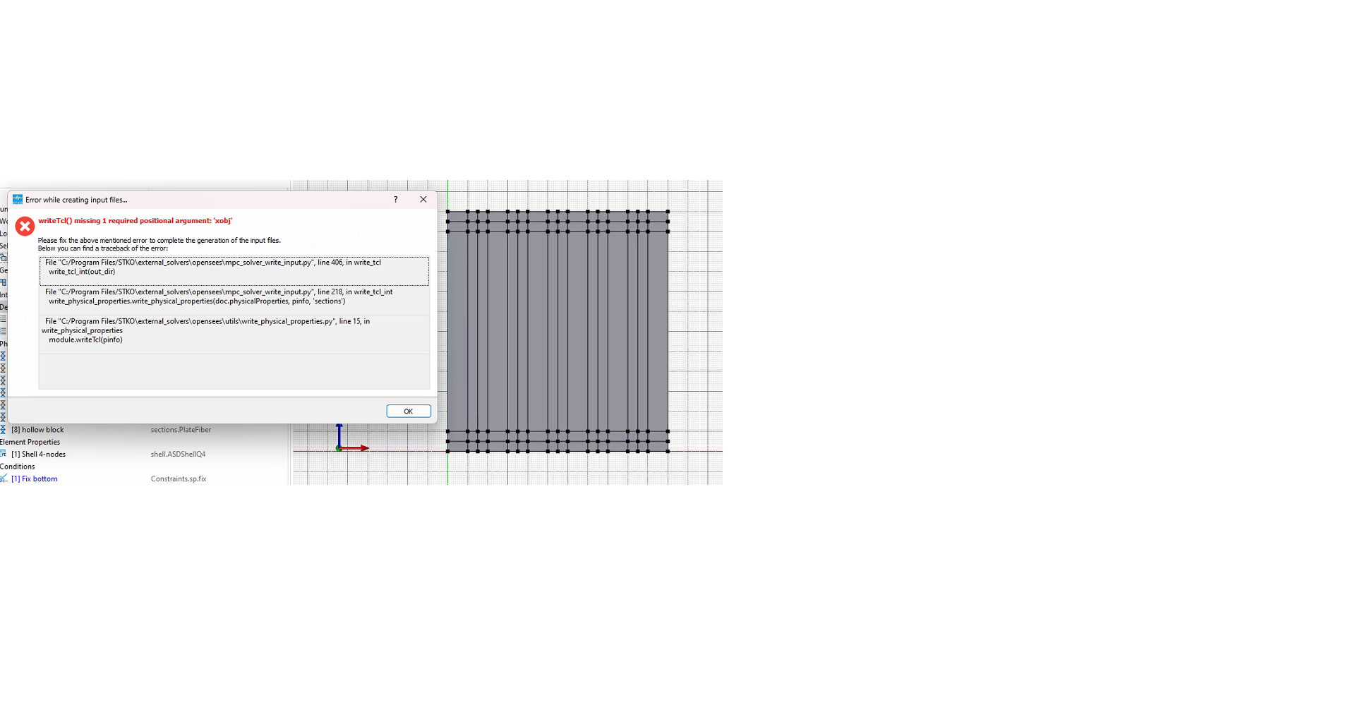

Hi STKO team,
I fixed the geometry problem and the problem with the top and bottom faces using a elastic membrane section in shell elements, but now apparently the problem is something else.

Post by bruznunez » Wed Sep 25, 2024 9:33 am
sorry, i forgot the picture and the model but here is.

Re: Error message while creating input files
Post by kesavapraba » Wed Sep 25, 2024 11:13 am
Hi, Your model works fine on my end. I use recent version of STKO v4.0 released yesterday. Please check the attached file. Use parallel version of OpenSees
Shear wall_RM-HCB-PG.zip
