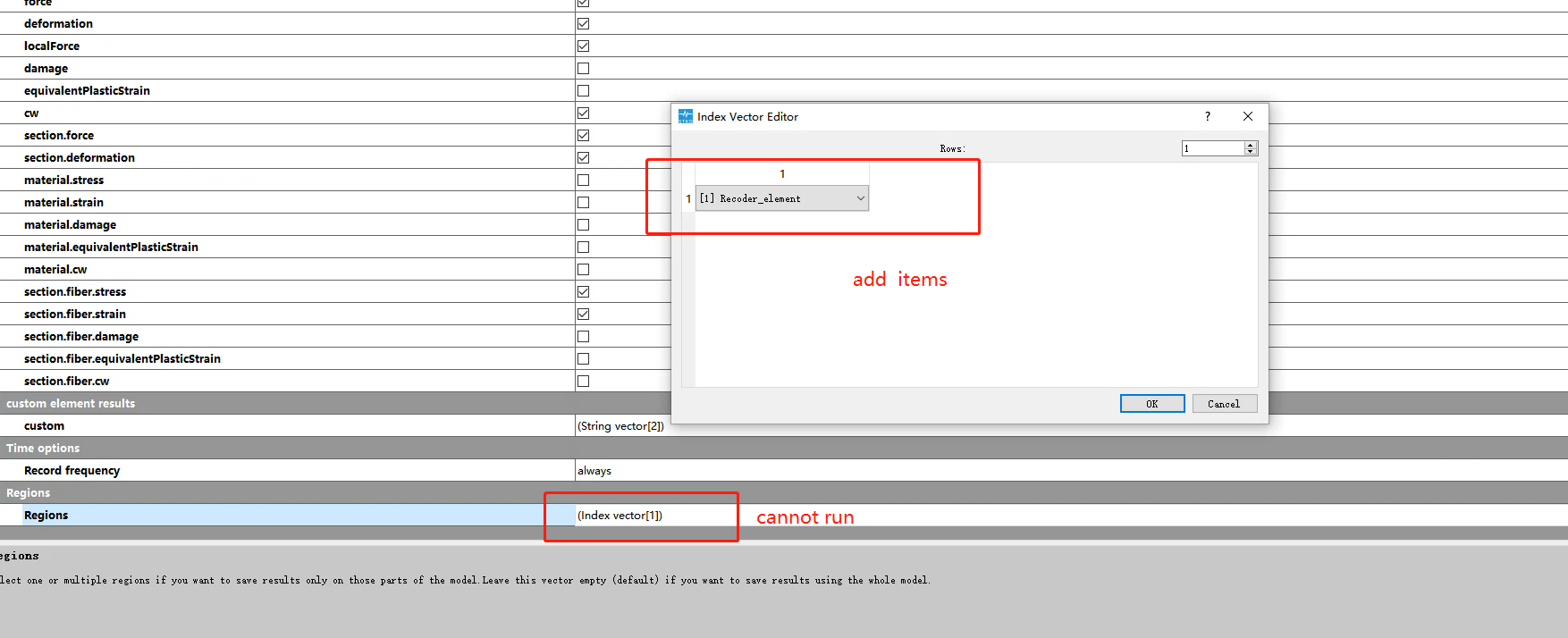

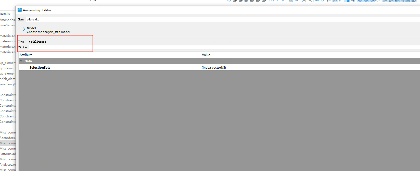

Thanks for your help, I have encountered a new problem with the MPCRecorder command, when I use the default way it works fine and records the whole model, however, when I just want to record the core area, it does not work. I checked the relevant information in the forum "viewtopic.php?f=29&t=1609&p=2064&hilit= ... ions#p2064" and the problem may arise from using MoelSubset, however For complex models, MoelSubset, is a must. I have provided a preliminary model, can you give me some advice?

You have to add the model subset before the region, otherwise OpenSees will put nothing in that region if the elements are not yet created
