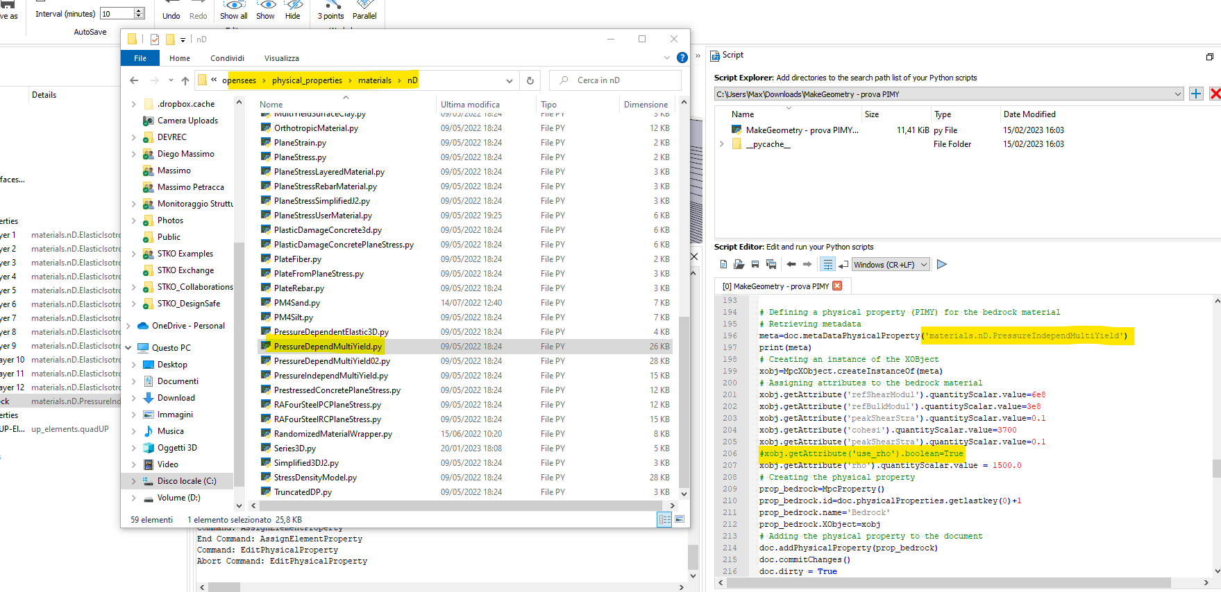

Hi team,
i would like to implement, within my python code, the materials pimy and pdmy to model my soil layers. The parameters are the standard ones for medium clay and medium sand that are on openseeswiki. I attach the file below
thanks for your help!!
- MakeGeometry - prova PIMY.rar
- (3.19 KiB) Downloaded 173 times
Re: Model construction with Python API
Just change these 2 lines (use_rho is not an attribute of PIMY, and PIMY is just in ND folder, without the sub-group name)

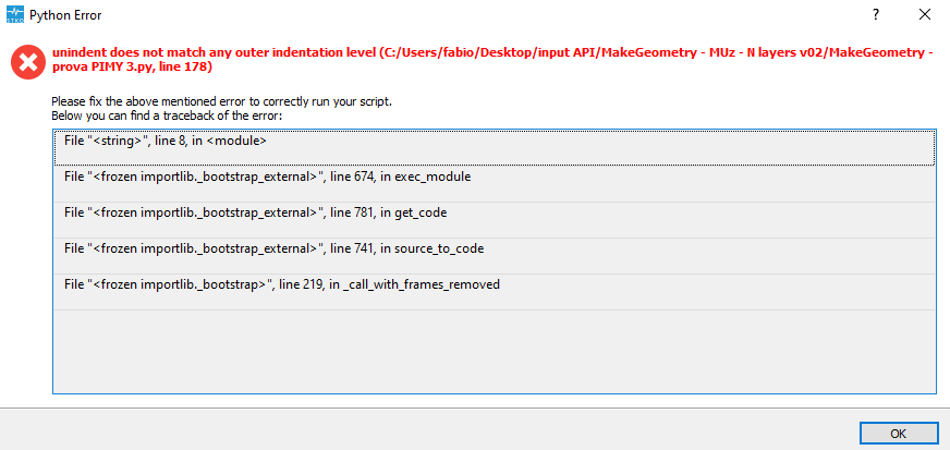

The material PIMY run well for bedrock but not for soil layers. Why?
The error is as follows.

Hi Fabiola,
Regarding the error. Check the indent on lines 178-181. With the correct indent, it works for me. Also, check one more time the indent for your mesh part with for loops. Let me know.
As Valentina said, you have indentation issues.
First in line 178 (as the error message says). Here you mixed tabs and whitespaces as indent (this is not allowed in Python). You have to be consistent in your file, either with whitespaces or tabs for indentations, don't mix them.
Secondly, you completely disregarded indentation in the nested for-loops for the meshing part.

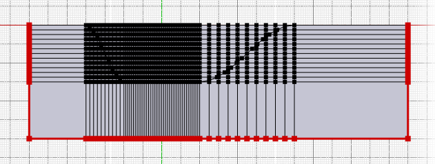

Now the focus of my work is to assign the AbsorbingBoundaries on boundary sides (as in the figure) by API python.
Can you tell me how I can write the tag correctly?
Sorry for all the requests.
I await your reply, thank you again.
- Absorbing.PNG (29.51 KiB) Viewed 3161 times
I added a code to select all boundary edges for absorbing boundaries.
Now you can proceed as we did for physical and element properties of the main geometry
