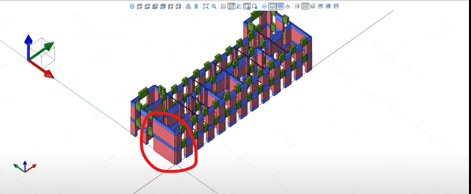

Is there any webinar that explains the equivalent frame modeling, in the case of a masonry structure ? I found this video (https://www.youtube.com/watch?v=TovQNKvmoqQ) on your youtube channel, but it's a little bit complicated and isn't commented.
I'm trying to model a masonry wall, but I'm facing some issues. I guess it has a link with way I modeled the wall.
Many thanks for your support.

Hi STKO team,
I am trying to model a wall without openings. Should I add between the piers some rigid zones as what you did in this video (https://www.youtube.com/watch?v=TovQNKvmoqQ&t=833s) ? And why you added them in that case ?
Thank you for the support !
Re: EQUIVALENT FRAME MODEL
Post by STKO Team » Wed Jun 08, 2022 8:38 am
It depends on how much they are connected in reality. It's up to you
