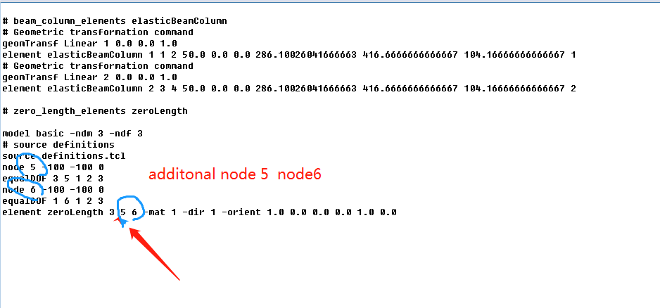

1 select interaction, node to node ,assisgn it to the same vertex of two connected line
2 assign zerolengthelement to the interaction
3 additional nodes is added in the node.tcl, which is not belonged to the left/right line element.
would you please tell the right way of build zerolength element on the vetext with the same location?

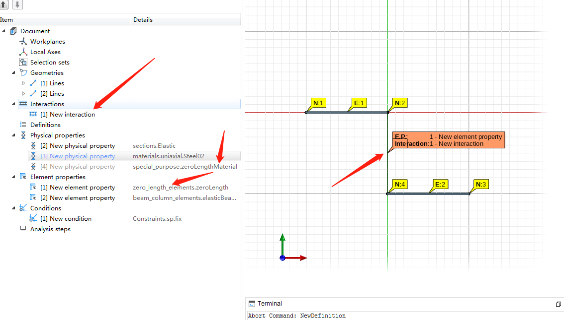

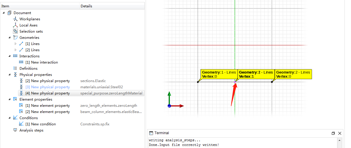

please see the pictures I get

Dear pan,
If you are trying to create an interaction between two overlapping nodes you can draw the node in a different location initially, then after you defined all the interactions move it back in the overlapping location.

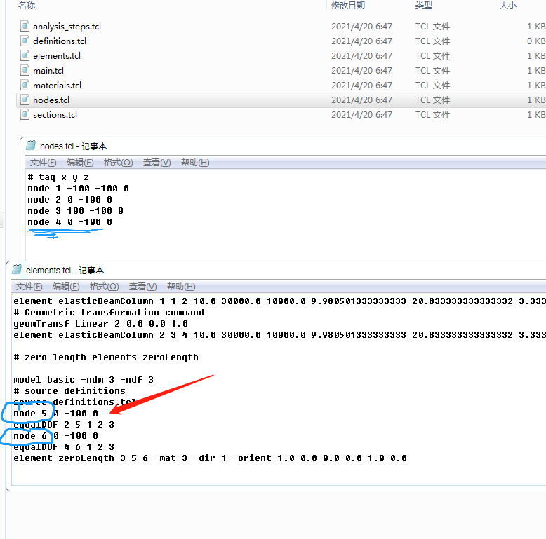

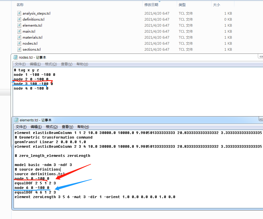

I try your method, draw two lines in different location, assign the interaction, then move line to overlap two vertexes, but in the element.tcl file two extra nodes appear to defining the zerolength element as following pictures. this method doesn't work (although in Abaqus software it works).
my purpose is not to build a hingedbeam with a lumped plasticity .
Looking forward to your reply.

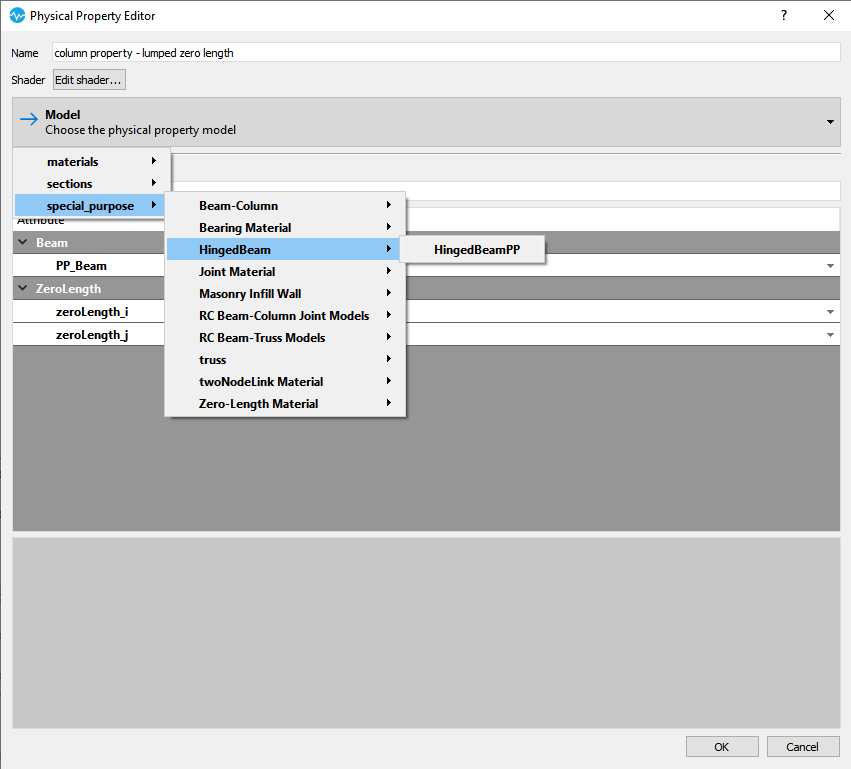

Re: how to build zerolength element between two vertex with same location
Dear pan,

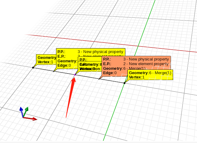

You do not need to create an interaction if you simply want to create a lumped beam, the geometries must be connected and merged, the zerolength is integrated in the physical properties definition.
Draw two lines, and create a wire with the Make Wire command selecting them both.
Then create the required materials and section you want to apply to the beam, and the zerolengthMaterial you want to assign at the nodes.
Finally you create a new physical property as special purpose > hinged beam > HingedBeamPP
and assign your zerolength to the nodes and your section to the beam property. Please do try to watch the webinar I suggested yesterday.
https://www.youtube.com/watch?v=94g7uhiqJ1Y
There are also these other two videos part of a course we did in Porto University about the same topic:
https://www.youtube.com/watch?v=fFegWww8vkE
https://www.youtube.com/watch?v=giZ80OsGypM
I realise they are very long videos, but they contain step-by-step procedures for solving questions like yours.
At the following links you can also find the example files used in those webinars.
https://asdeasoft.net/?webinar
https://asdeasoft.net/?university-courses
If you have further questions please attach your model in a .zip file to your next post so we can provide you an explanation directly on it.
Enjoy your modeling
Francesca
