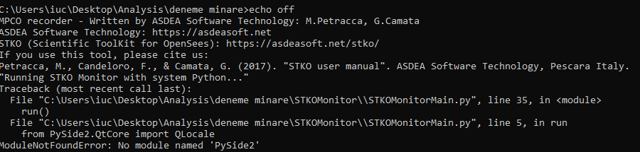

Thanks for the reply. I attached an image of the error I get. Single processor works well.

Oh ok... This is a very rare problem that happened to a just 2 other users. On some windows 10 PCs, when running OpenSeesMP (due to some admin restrictions) it does not read an environment variable that tells the Monitor that we can use Python inside STKO. So it tries to use the Python on your system. But your Python does not have the PySide2 package that instead is available if you run it via STKO's Python.
Once the analysis started, you can simply run the monitor manually, open a terminal windows in the directory where you have your SCD file. There you also have the STKOMonitor Directory. type
.\STKOMonitor\STKOMonitor.batRe: OpenSeesMP and Monitor Function
