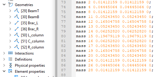

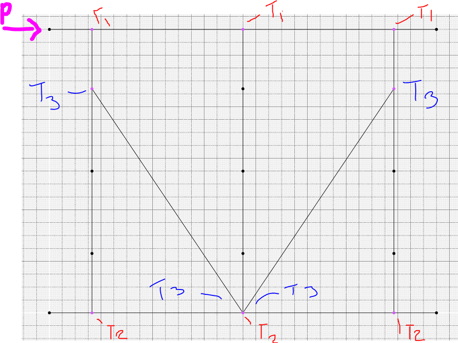

Hi, I work in a model of Timber frame and make different interactions in the nodes, used tree types of elements for each one with contact ZeroLength... and I can run the analysis
the columns and beams work with polylines because in each node I put some mass

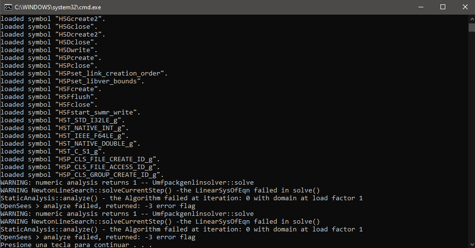

but when I run the analysis for the pushover analysis give an error, I can found these
Why I have this type o error??
I add the file because I can't understand what is wrong

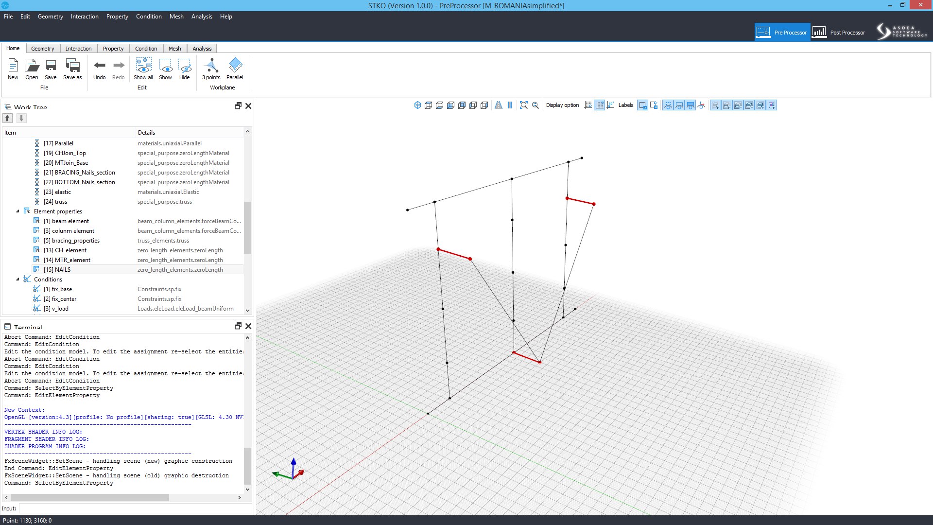

Re: ANALYSIS_WARNING
dear User,
when you merge geometry connection are assumed wth geometry, so we add the only interaction necessary in your model case.
As shown in the attacched images, we didn't assign the properties on nodes, but on the interaction. It is possible to add more condition on the same geometry (as well as on the same interaction), but only one physical or element property.
Please, let us know if you need anything else.
Have a nice day.
Have a nice day.
