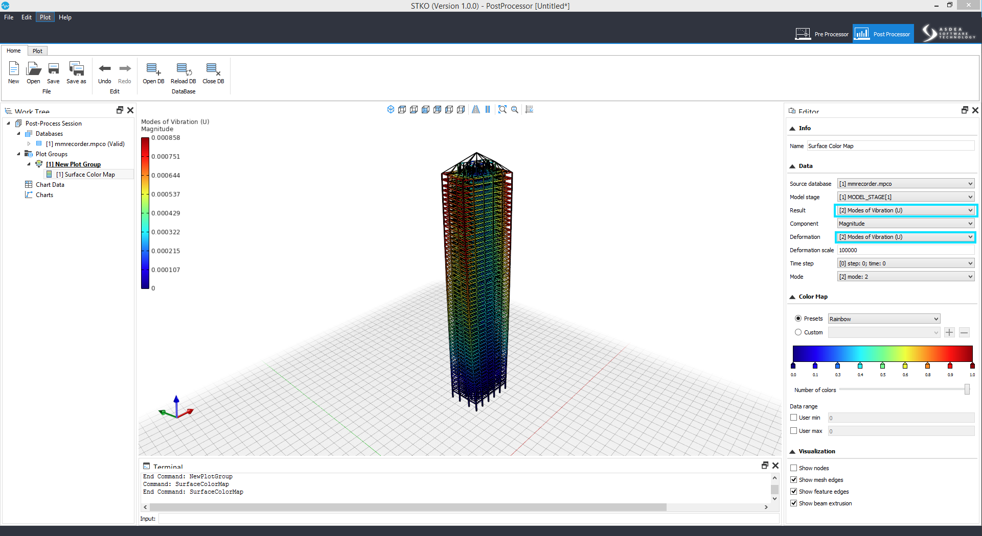

I have finished my analysis, with eigen and static.
In the eigen analysis, I also add customcommand and select modesofVibration.
So, how to show the vibration modes of the model in the postprocess?
Re: how to see the vibration mode
Posted: Thu Nov 21, 2019 8:42 am
Dear Yulu Liu,
you should choose modes of vibration both in the result and in the deformation drop down menu.
