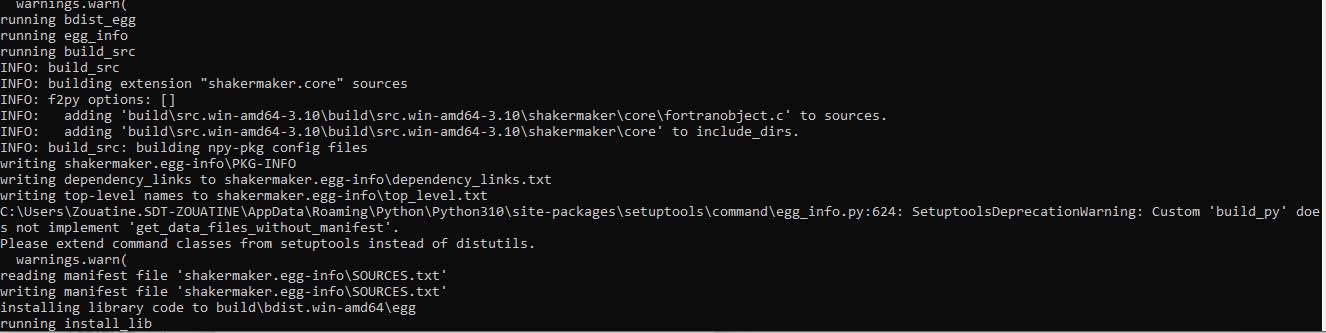

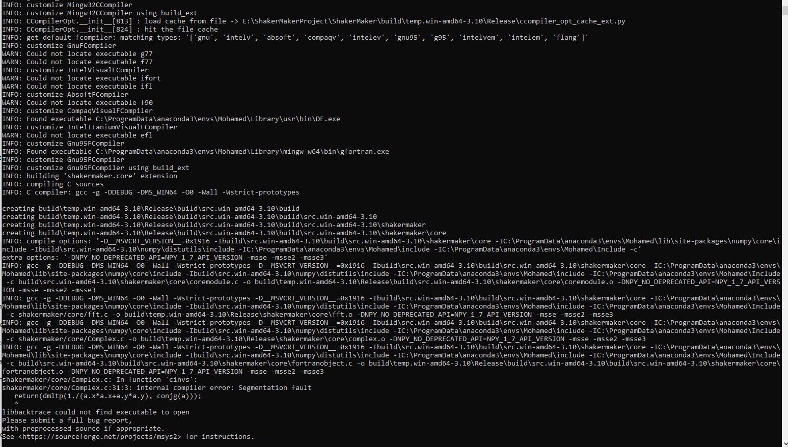

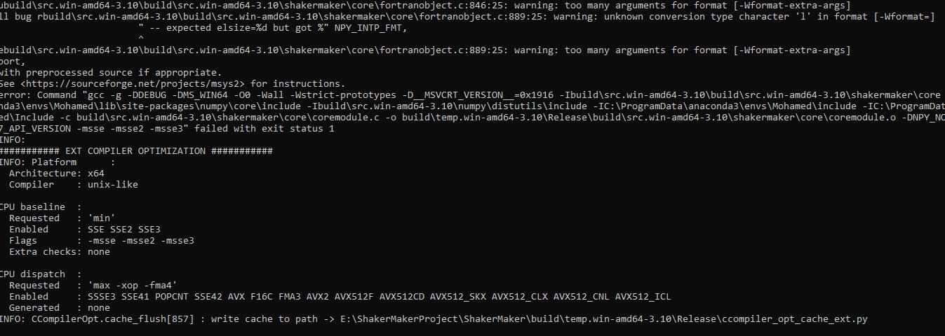

I have attempted multiple times to install ShakerMaker within an Anaconda-created environment. I also tried running the code in Visual Studio Code, following the installation instructions provided on GitLab. However, I consistently encounter issues when executing the command:
sudo python setup.py install
The error appears to be related to the Fortran compiler. Since ShakerMaker contains components written in Fortran, it seems these parts are not functioning correctly. When I run the installation command, I receive the following error:
Would you assist me to resolve this issue ?

Re: STKO’s Domain Reduction Method
Dear user,
This is not an STKO-related question, so we cannot give you extensive help on this topic.
However, not that compiling shakermaker in python requires the F2PY module. It's a module used to compile fortran code and interface it with python.
As you can read in this documentation https://numpy.org/doc/stable/f2py/windows/index.html, Anaconda has F2PY with the MSYS2 MinGW compilers, which are outdated and not recommended.
I would suggest you to install Intel One API compilers and do it from your native python (not Anaconda), but be prepared because you need some experience with compiling code
