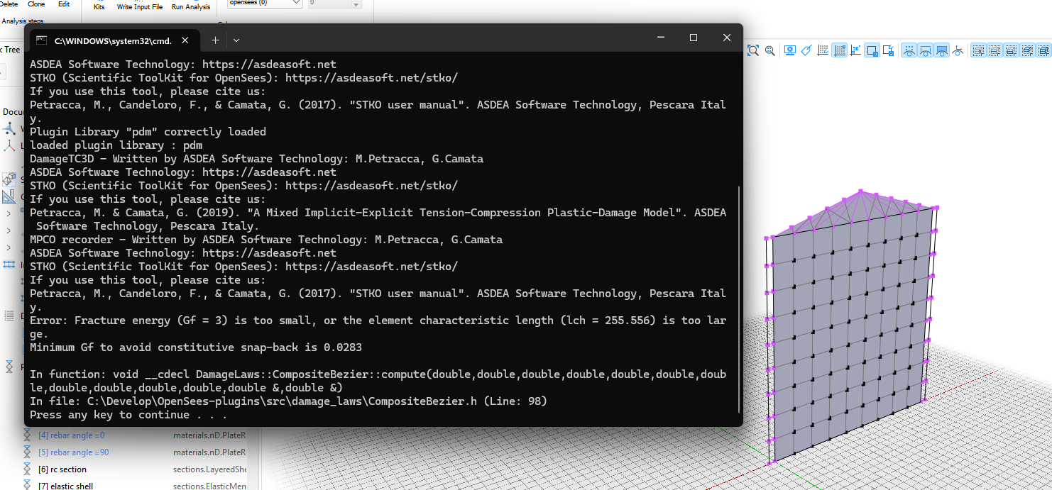

I tried modelling the shear wall as shown in the video. I followed the exact same steps and I got this error (attached file). How do I resolve this? Additionaly I had to also change the divisions by size as max number of nodes was reached.
Do I need to download a different solver?

I managed to resolve this error. I changed the Gc value from 3 to 10.
Re: Urgent: Analysis of plate structures
Post by STKO Team » Tue May 20, 2025 8:08 am
Yes It has been discussed on another topic as well
