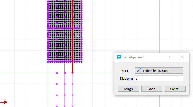

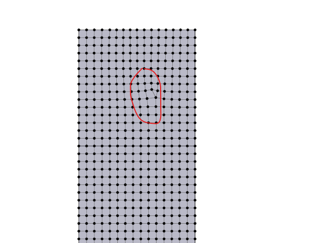

The error is due to the use of ASDShellQ4 on a mesh that contains triangles:
Reason:
The top surface is not a 4-sided surface, thus cannot be mesh with a structures quad algorithm Solution:
Add lines to cut the surface into all 4-sides surfaces, like this and use the merge command: Other issues:
Now your model will not run due to singularities. They come from the way you are using a truss and how you are linking it to the ground and to the wall. Please review the connections

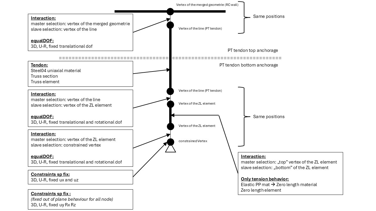

thank you for your quick reply. I tried different configurations this week for the unbonded post-stressed tendons, but the model did not converge. Without the tendons, the model run perfectly (the model is like a conventional RC shearwall).
I'm relatively new to the opensees community, could you help me find the cause of the convergence? I have read a lot about the elements on the berkeley's and openseespy's websites, but i can't find the issue.
I drew a shematic overview about the configuration of the tendon: I have also attached the current version of my model.
Please suggest if you think another solution would be more suitable for modelling the post tensioned tendons
Thank you in advance!

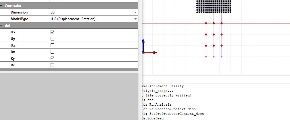

I think you can simplify the way you modelled you tendons...
Anyways, pay attention when you model with trusses and translational-only springs: you have to fix with rigid body rotations:
- Trusses SHOULD NOT be meshed, otherwise your internal nodes will be free to move in the X direction (rigid body translation in X + rigid body rotation about Y)
- Same thing here. Don't know why you put these in series like this, but if you really need to do it, pay attention to UX, RY rigid body modes
