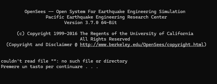

yes i'm sure, it is the right file. The message it's the seguent:
screenshot of the RunSolver
Immagine 2025-03-27 105228.png (25.24 KiB) Viewed 2526 times

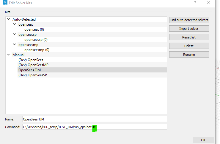

You didn't set up the solver command properly.
maybe you forgot the #1 keyword that STKO uses as a placeholder for the tcl file name (and in your case is empty):

by Giorgio Serra
Thanks for the support, now it works!
