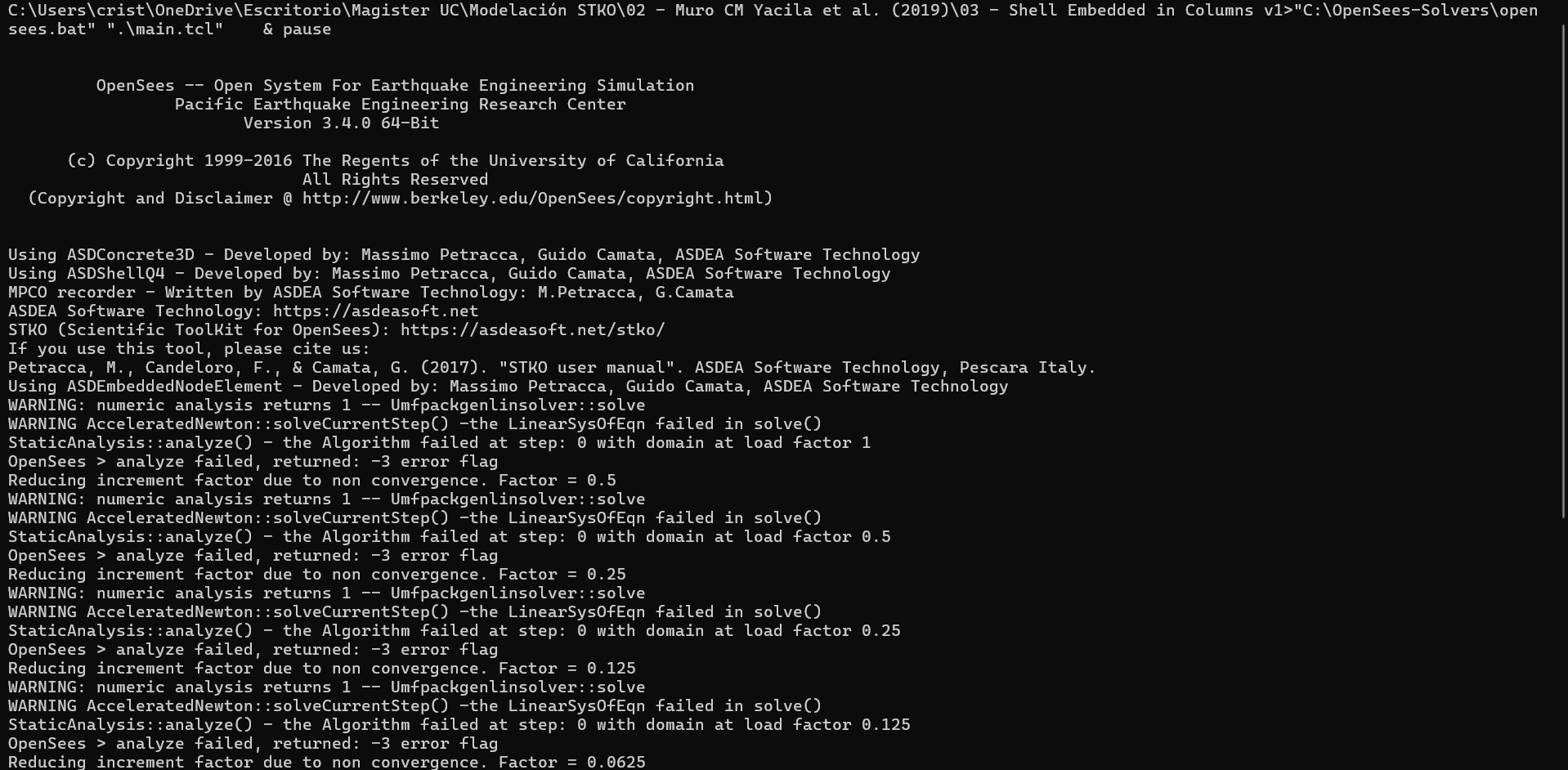

I am generating a model of a confined masonry wall with embedded rebars in the columns. The columns and the wall are shells, so the rebars are embedded in shells. But I am getting the error that I attach as a screenshot. How can I fix that? Please I need an answer. I attach the model in STKO by the way.
Thanks in advance!!!

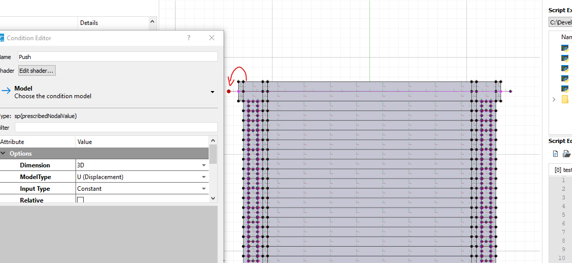

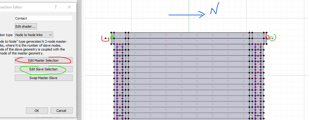

I solved the problem about the embedded rebars in the shell, but right now I can not generate a contact in the roof of the wall with the goal to avoid the push/pull effect in a cyclic analysis. I followed the guidelins of the webinar "Modelling RC Shear Walls in OpenSees and STKO - Shell and Solid Models with Embedded Rebars". In this video, Massimo Petracca developed an embedded solid model, but I tried to do the same with a shell on the columns as you can see on my model. I really appreciate if someone could help me with this.

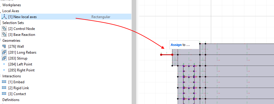

Re: Embedded rebars with shell
This works:
Errors:
- The push point should be the outer ones (I moved them apart so that you can see the changes)
- You forgot to assign the local axes (local Z is the normal contact vector and is oriented along the global X axis)
- Master -> Slave direction should be consistent with the normal contact direction
- Finally, I removed the rigid link in the contact points (it's useless, you can simply apply the imposed displacement on both points, so that they move of the same amount in X). Ans you also need to fix all DOFs but the UX in the contact points (they are just used to apply the Ux motion)

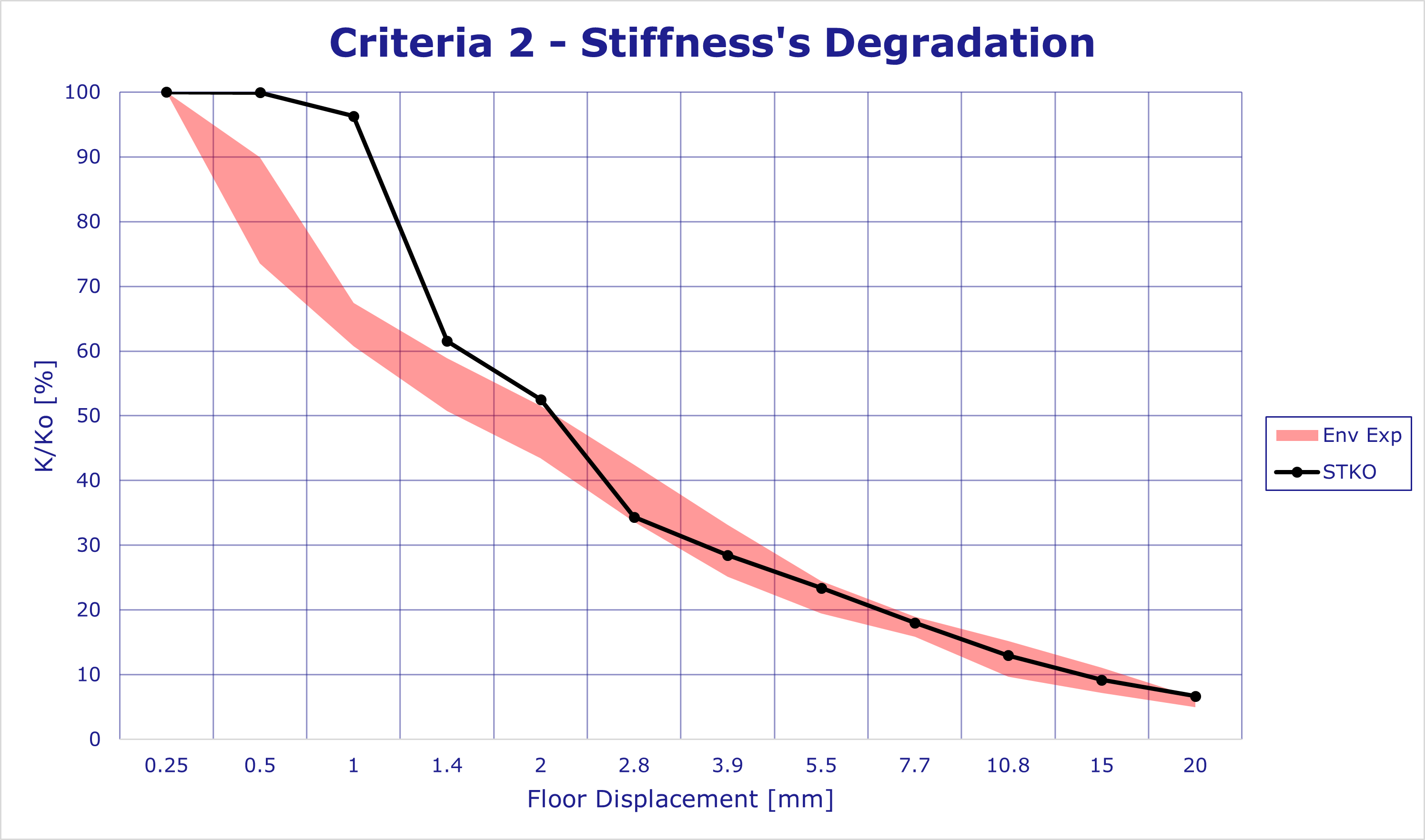

Hi!
I am trying to introduce new boundary conditions and spite of I obtain differents results, my main problem it's the stiffness's degradation. As you can see in the image that I attached, the red zone is the envelope of three experimental results; the STKO results works fine in large displacements but it doesn't fit fine in the first cycles. I had tried by reducing some tension's parameters in the columns and the masonry's panel, but I can't avoid this effect. I don't know if this is a feature of the ASDConcrete3D, the setup of the cyclic analysis or something like that.
From the experimental envelope it seems the overall stiffness degradation starts at earlier displacements. Check some pictures of the experimental damage pattern at that stage to understand if that overall degradation is due to cracking (in this case it means you have to adjust tensile parameters).
If there is not cracking at those displacement, it means that the apparent initial stiffness degradation is due to something else
