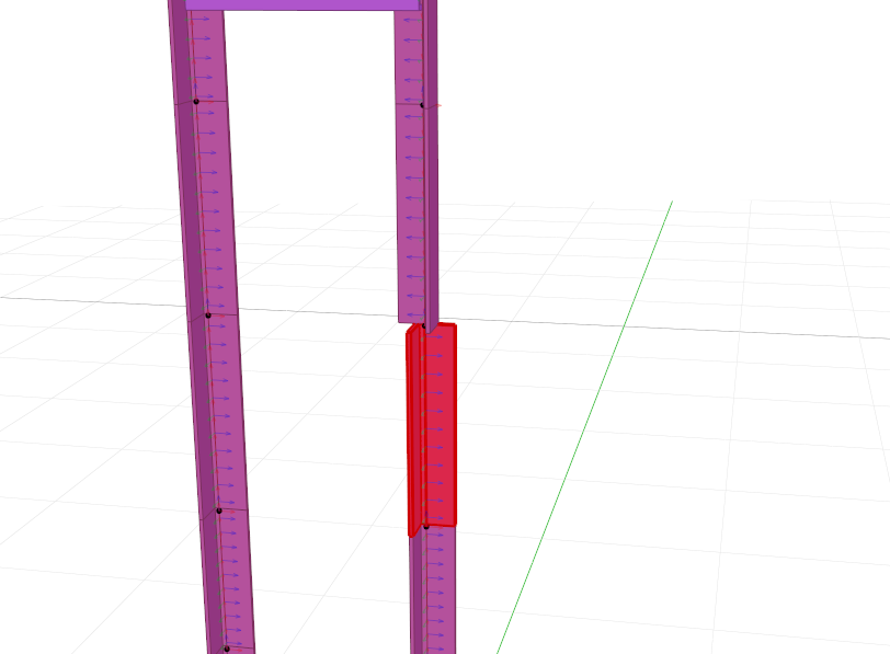

Hello! Could you please tell me how to change the coordinate system of the following geometry so that the directions of the steel materials in the upper and lower parts are consistent?
Re: How to solve the following problem
Post by kesavapraba » Sat Mar 08, 2025 10:11 am
Hi, Please define "Local Axis" as seen in other elements and assign it to the element that needs modification. To understand about local axis, please refer to STKO manual document.
