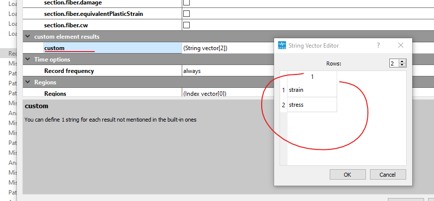

It's because some elements in OpenSees (those with only 1 gauss point, like the SSPBrick you are using) do not follow the rules and do not accept the material keyword before a gauss point result (like material.strain or material.stress).
For these few element, you need to use custom element results, like strain and stress, omitting the material. in front of them
like this:
