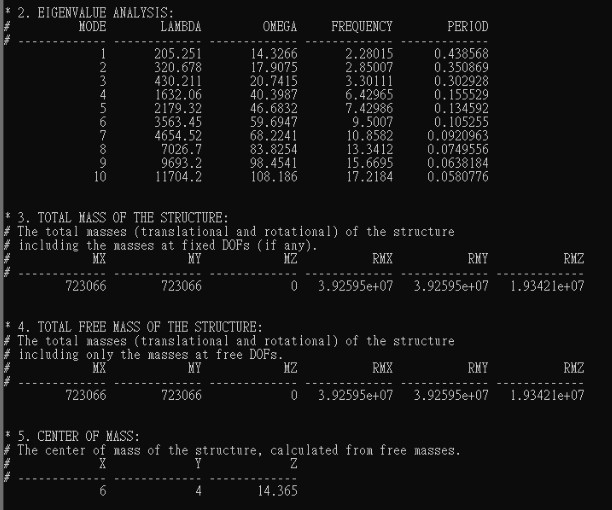

In the test, the natural period in the x-direction is 0.85s and in the y-direction is 0.58s. In my fiber model, the natural period in the x-direction is 0.44s and in the y-direction is 0.35s (Figure 1). This suggests that the fiber model is significantly stiffer than the test results.

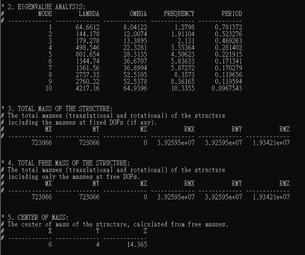

To ensure that there are no issues with the size of my fiber model, I also created an elastic model, keeping all properties the same except for replacing the fiber sections with elastic sections. After running the modal analysis on the elastic model, I found the natural periods to be 0.78s in the x-direction and 0.52s in the y-direction (Figure 2), which are closer to the test results.
