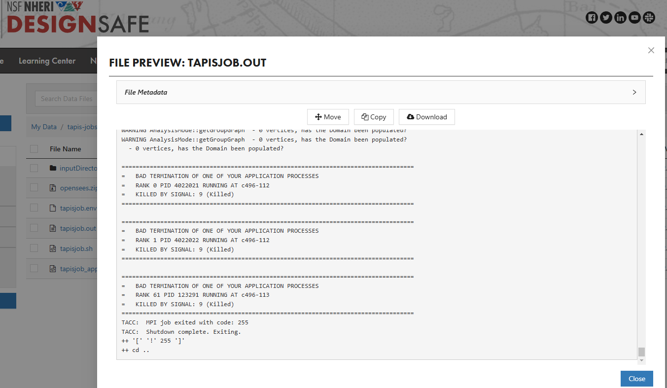

I carefully consider your webinar material. I found some traces in the past events of DesignSafe. However, at the current time, it contains only OpenseesMP and OpenseesSP in its digital platform.
In this regrad, I try to run my simple Opensees codes which are obtained in way of being genrerated by STKO.
But, I can not obtain any files with an extension of "*.mpco". It is resulted with errors (See DesginSafe_For_Forum.PNG)

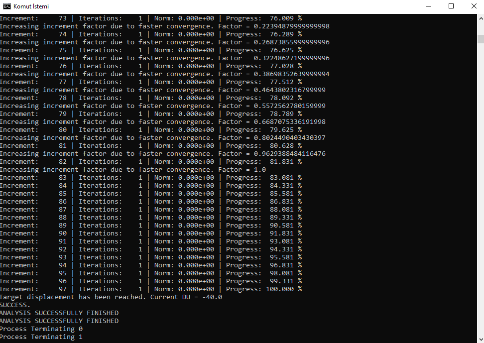

However, these codes are sucesfully run in DOS command system as "openseesmp.bat main.tcl 2" (see OpensesMP_For_Forum.PNG)

Since I can not receive any reply, I wrote "https://www.designsafe-ci.org/". They suggest me to contact with you in order to control against any incompatibility for the current version of OpenseesMP (v3.7.0) which is currently embedded in the platform of Designsafe.
When I check the version of OpenseesMP under "OpenSees-Solvers" which is utilized by STKO, I can see that its version is v3.4.0.
However, I do not know the reason behind the failing of correctly running the Opensees files generated by STKO under OpenseesMP (v3.7.0) which belongs to the platform of Designsafe.
I sent you a typical output generated by the platform of Designsafe (see tapisjob.rar).
This matter is really important for me in order to sucessufully run the models with the finer-meshed of solid elements.
I look forward your reply, impatiently

Re: Openseesmp and Design-Safe Plaform
WARNING AnalysisMode::getGroupGraph - 0 vertices, has the Domain been populated?Are you sure you partitioned the model in STKO with the same number of processors you are using on DesignSafe?
