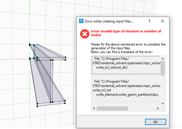

This post is my second one. In fact, it is one of the trials for the analysis a simple w-shapeed profile using "solid element". At this time, I utlize the partition command in order to merge the flange and web parts (see cantilever_I_beam_BilinIMK_Solid_2.rar). The main reason behind this is unfortunately related to the "union" command because I can not obtain a structured hexagonal (regular brick) form.
However, at this trime, again I get a error mesage as "invalid type element usage" (see error_cantilever_I_beam_BilinIMK_Solid_2.PNG). I think tha this reason is arisen from the unregulzarized node mesh.
what must I do in order to analyse a simple cantilever solid beam with w-section?

What do you mean by "partition" command?At this time, I utlize the partition command in order to merge the flange and web parts (see cantilever_I_beam_BilinIMK_Solid_2.rar)
Of course, the union command removed the internal faces of the solids. A structured hexa mesh can only be done for volumes with 6 faces (each face should have 4 sides).The main reason behind this is unfortunately related to the "union" command because I can not obtain a structured hexagonal (regular brick) form.
Use the "merge" command instead (unlike the union, it keeps the internal faces)
Finally, the error about the invalid element type, is due to the fact that you assigned the ElementProperty (stdBrick requires a hexa with 8 node) not only to the volumes of the geometry, but also to its boundary faces/edges (and they are not meshes with 8 nodes!)

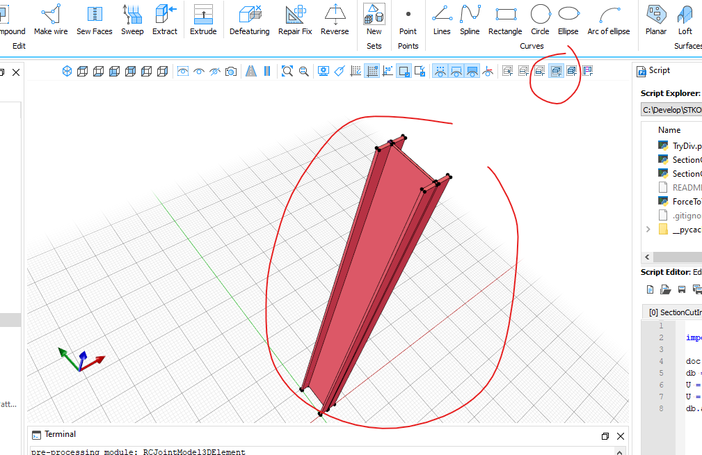

Check this:
It seems that you didn't read the previous reply
Use sub-selection for this: There were also other small mistakes I fixed (material not assigned to solids, no selection set for displacement control analysis).
Finally I don't really understand what you are trying to do with that equalDOF, and there is no load, so the Displacement Control Analysis cannot start.
I would suggest you to start from the basics of STKO and OpenSees using the getting started webinar series
The element should be assigned only to the sub-solids of your geometry (not to the boundary faces/edges).Finally, the error about the invalid element type, is due to the fact that you assigned the ElementProperty (stdBrick requires a hexa with 8 node) not only to the volumes of the geometry, but also to its boundary faces/edges (and they are not meshes with 8 nodes!)

Let me show you how I would do it.
Let's assume you want a cantilever beam (fixed on one side, and a constant shear force on the other side)
You have 2 options:
You have 2 options:
- Either assign a constant Face-Force (stress) so that this value times the area is equal to the total force on that face
- Or create a control node (similar to the reference point in Abaqus) and link it to the face of the beam with a beam-solid-coupling
