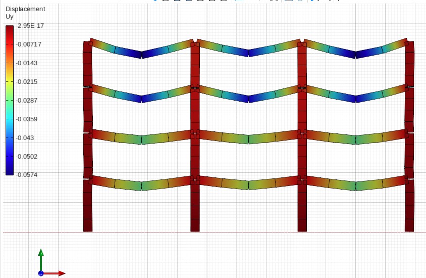

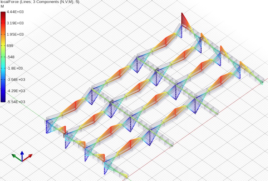

I have developed a 2D planar model where I performed a modal analysis and an analysis under gravitational loads. When evaluating the results, I noticed that the deformation due to vertical loads is adequate; however, the direction of the moments is incorrect. This issue prevents the plastic hinges I have defined from forming as expected.
I would greatly appreciate your help in identifying the problem. I have attached the model for reference.
This is true, but it's only a visualization issue. In a 2D analysis, OpenSees does not happen y or z to the "M" output. So STKO doesn't know if it's My or Mz. In a 3D model this issue does not happen.
