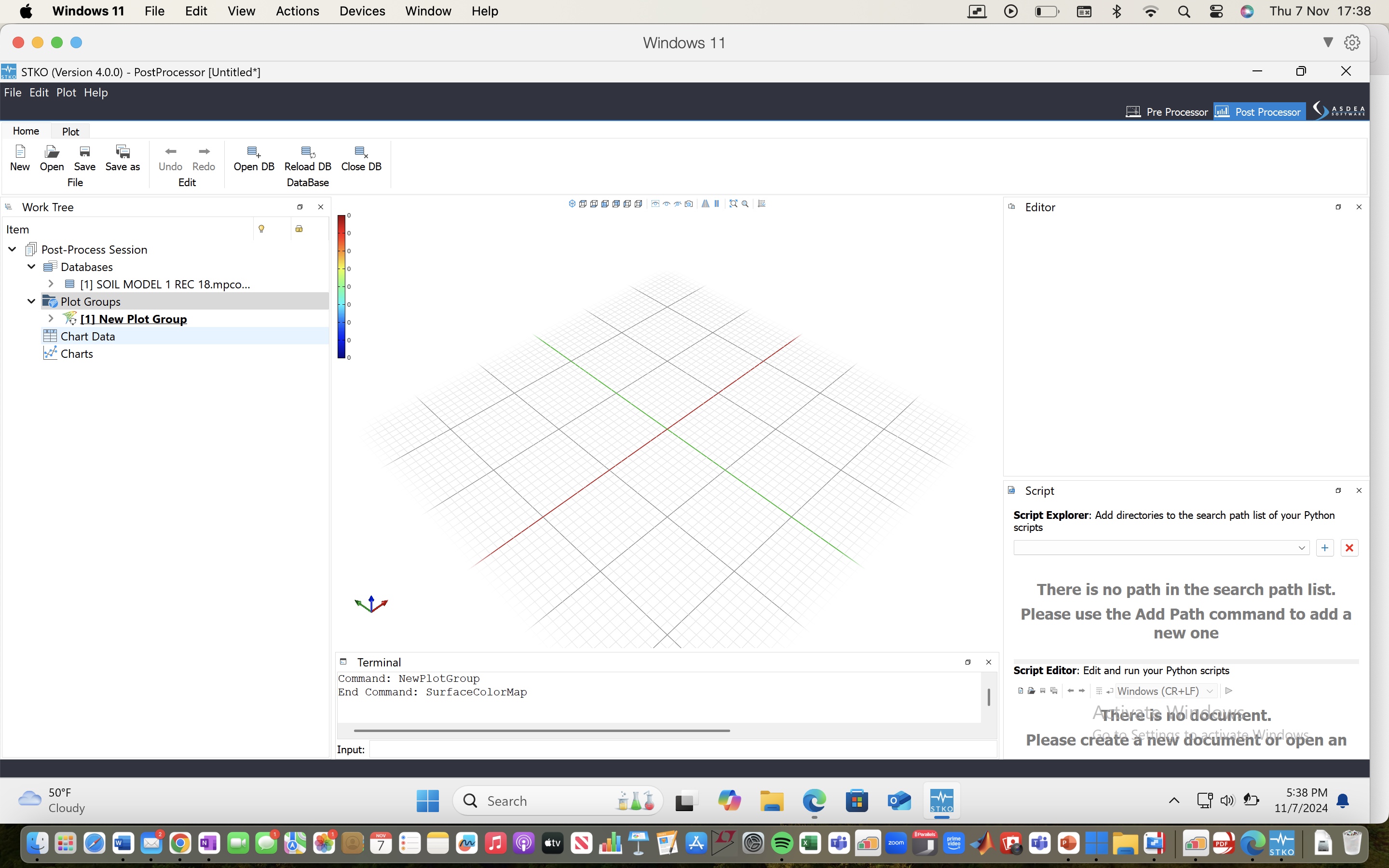

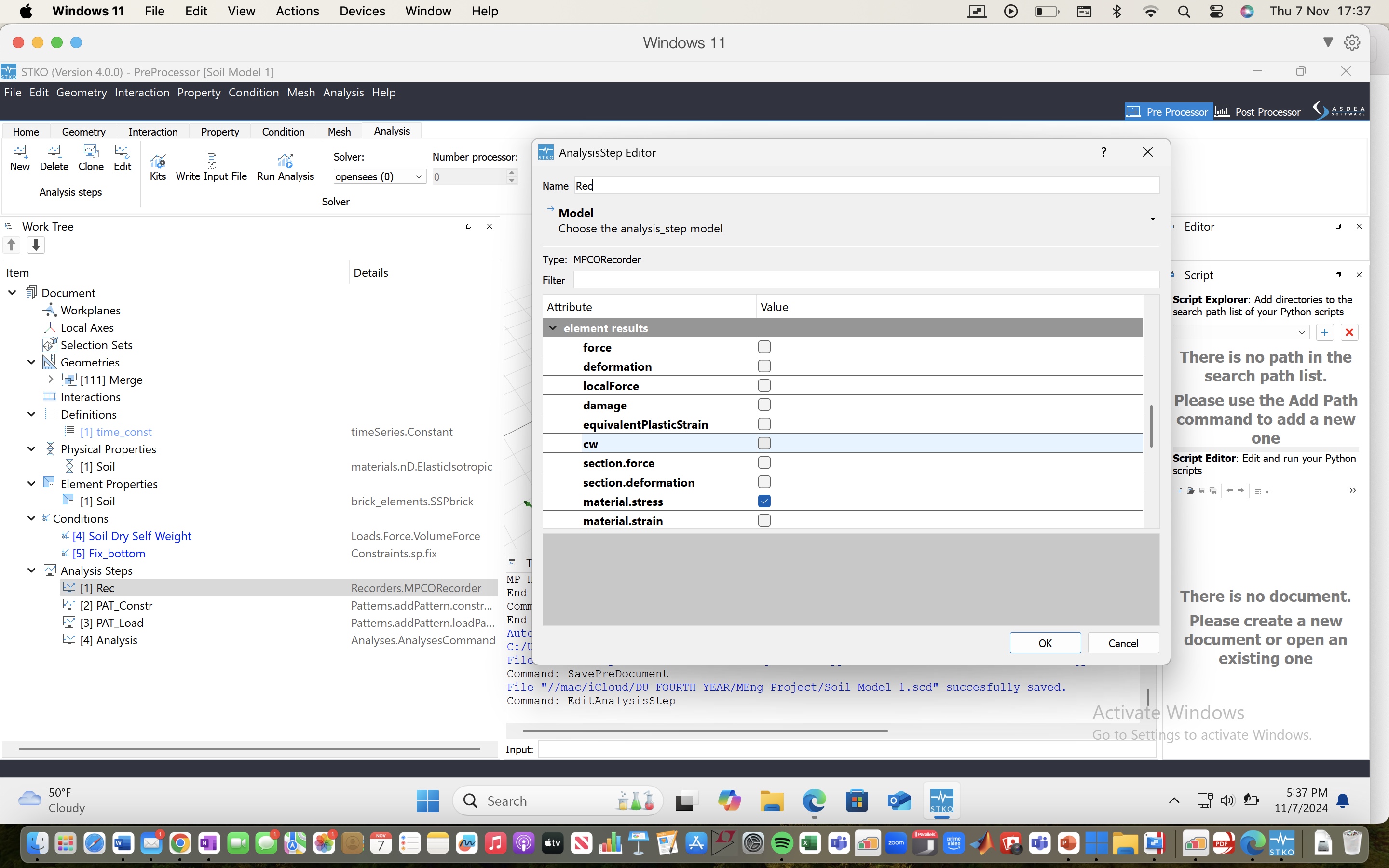

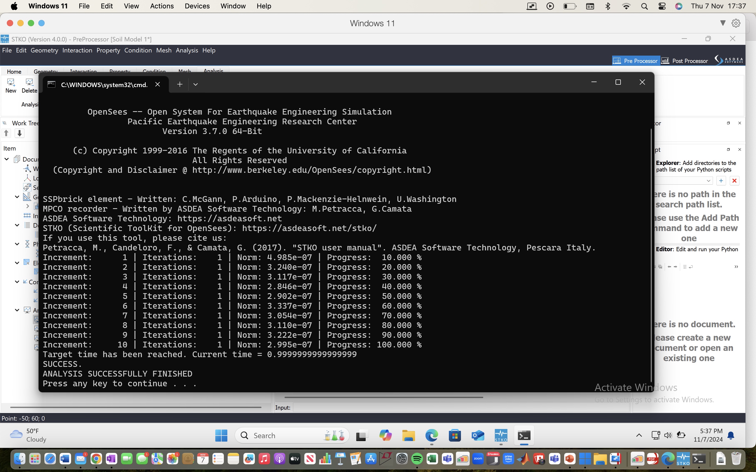

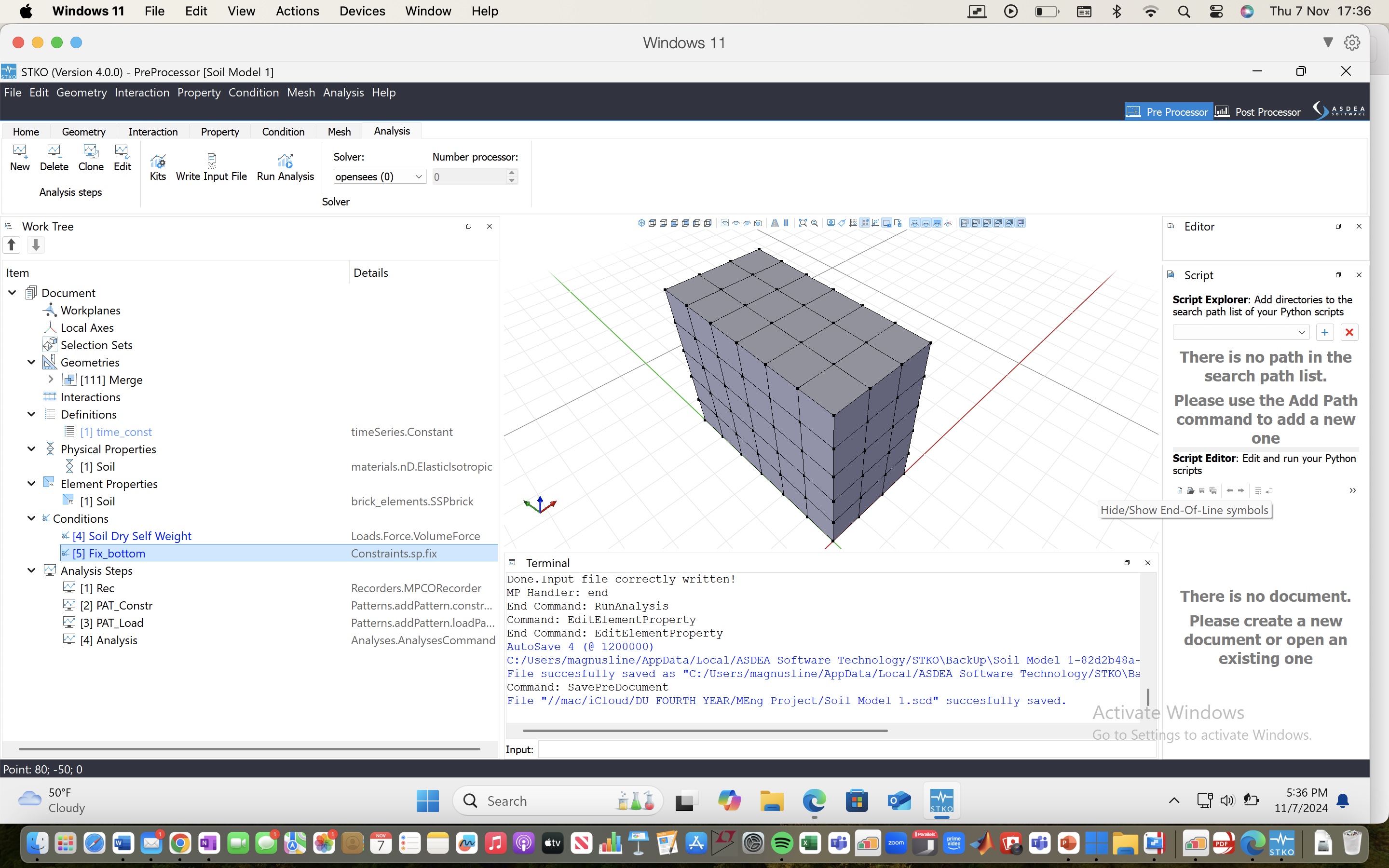

I have build a soil block model and I am trying to measure how the stress varies with depth. I can see the results when I select value under nodal results. However I cannot see my results when i select a value under element results. I am not sure why this is. Please see attached.
Help will be greatly appreciated.

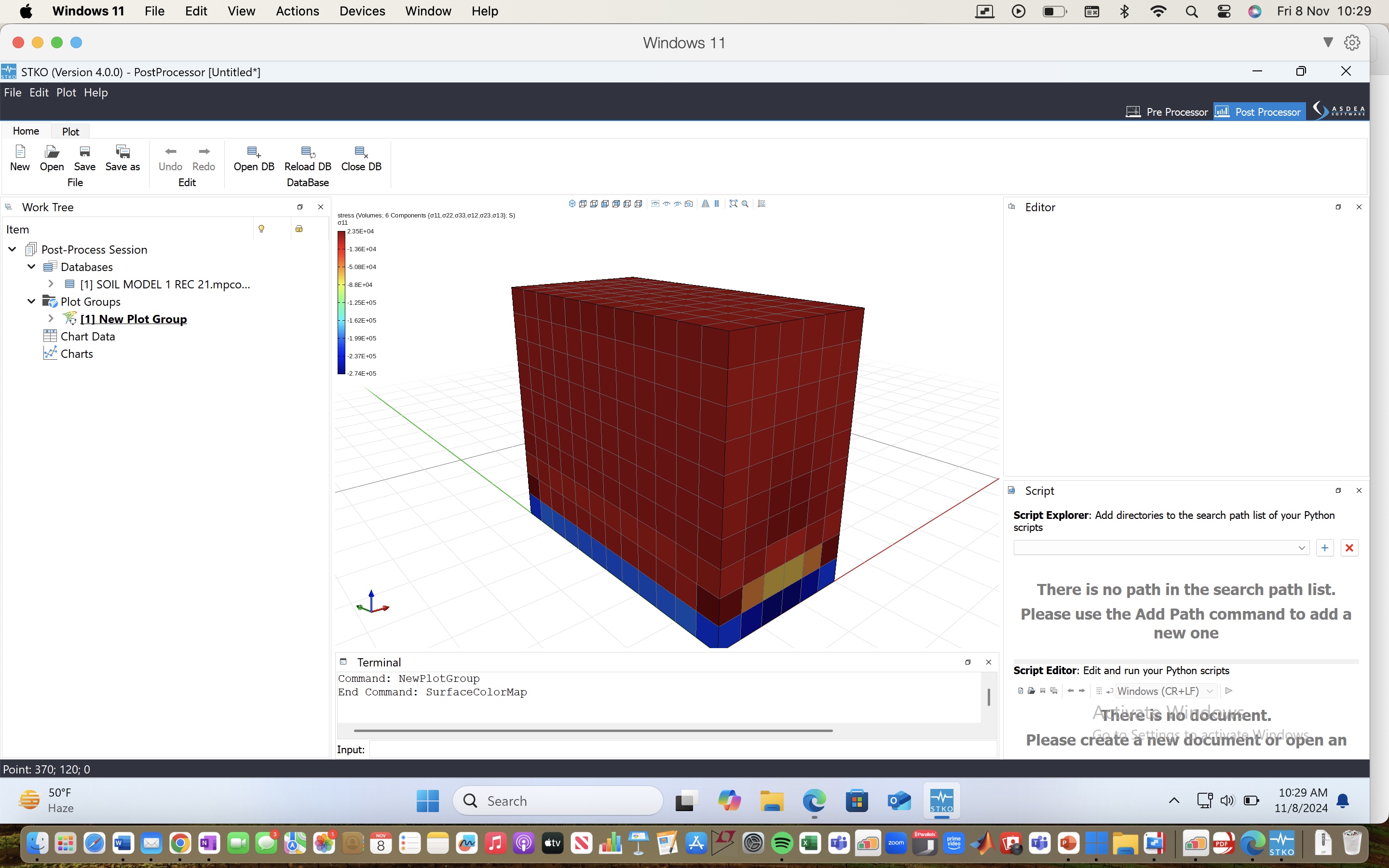

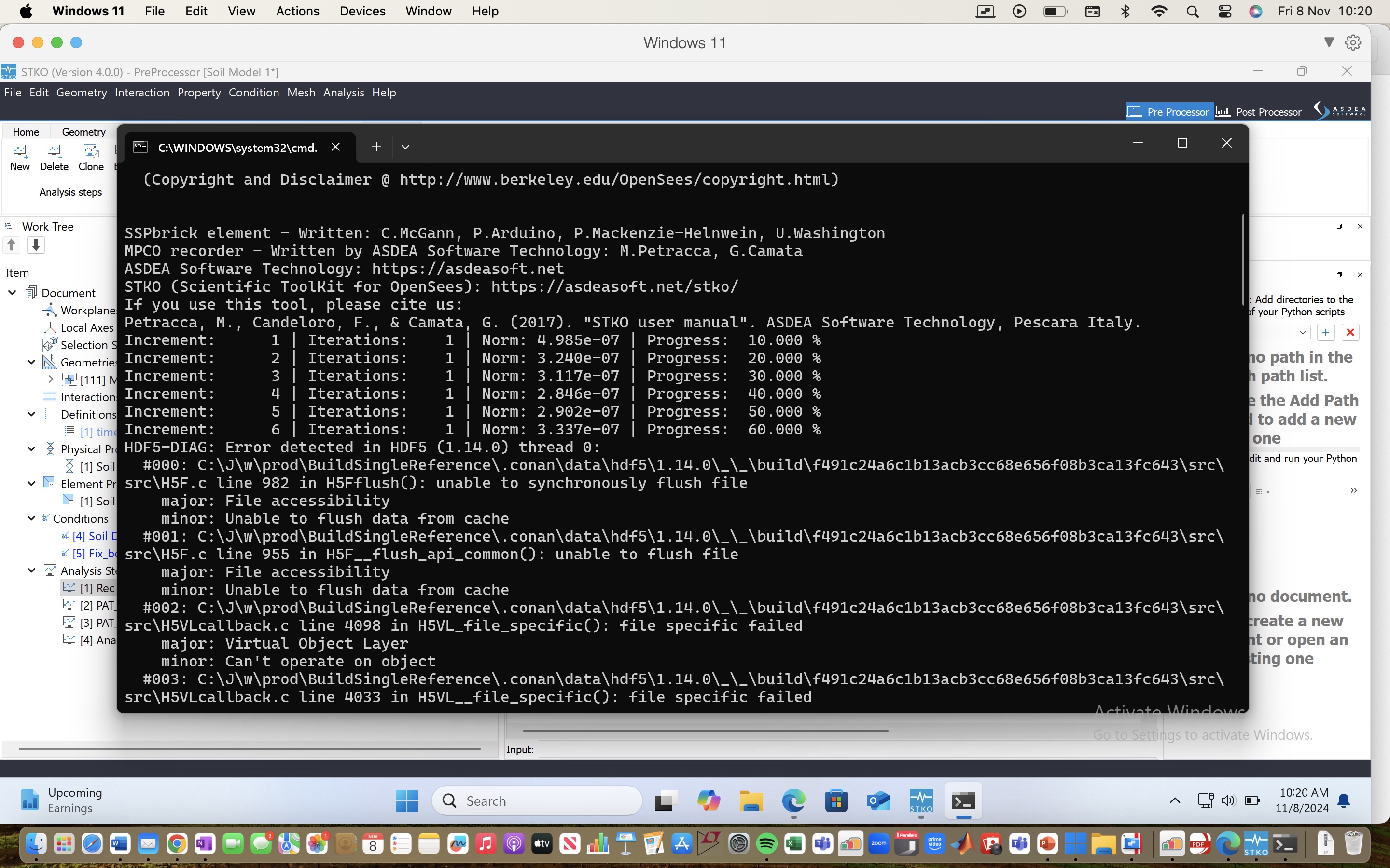

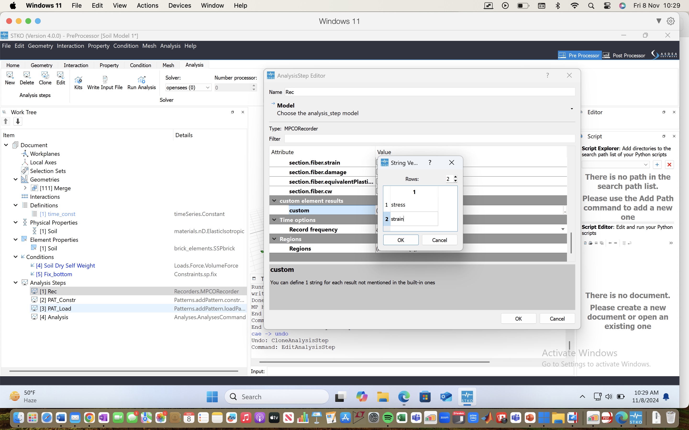

UPDATE (Still need help): I have fixed this by putting in custom element results. However I get error messages. Why am I getting this, should I be concerned? Please help.

Re: ELEMENT RESULTS NOT LOADING
Post by STKO Team » Mon Nov 18, 2024 10:02 am
Yes SSPBrick does not support the material keyword before stress and strain.
Regarding the second issue, don't be concerned. It's a warning of a new library we use for the MPCORecorder. We'll mute that warning in the next version
