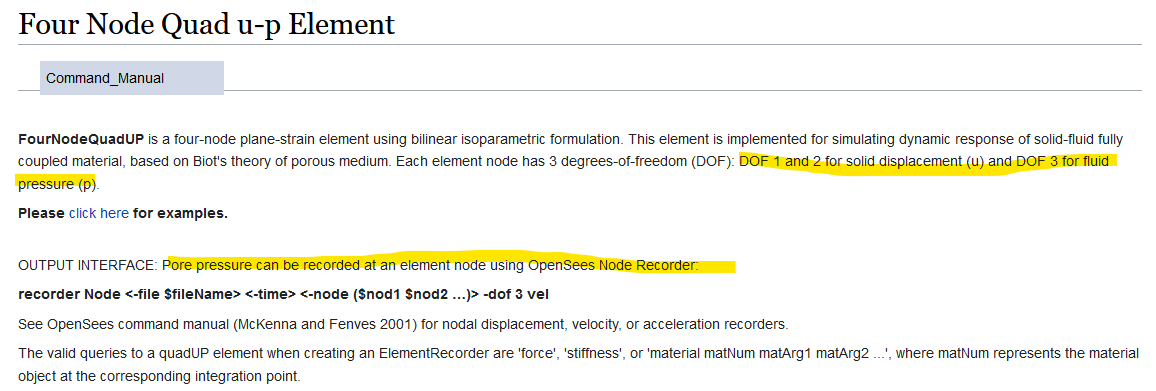

Hello dear STKO team,
Can we conclude the "pore water pressure" in the soil from STKO? I asked this question because there's not this parameter in recorder!
Please guide me.
Thank you so much.
Re: Pore water pressure
Post by kesavapraba » Sun Nov 10, 2024 11:02 am
Hi, Node recorder, corresponding to the DOF, should provide the pore water pressure. Hence, a separate parameter is not warranted. Please check the attached description.
Post by STKO Team » Mon Nov 25, 2024 10:34 am
In the MPCORecorder you can ask for Pressure under nodal results.
