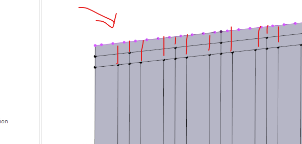

There are some errors in your model:
Try to fix these 2:
  • Your geometry has some faces that cannot be meshed with structured quad mesh (they have more than 4 edges). If you want to keep it as it is, switch to unstructured triangular mesh, and choose a triangular shell element. Otherwise, cut your geometry to make it suitable for structured quad mesh:
    extra cuts.png (15.81 KiB) Viewed 506 times
  • You are using a uniaxial section for an elastic timoshenko beam: it's not correct. You should either use an elastic section with an elastic beam, or a nonlinear section (for example fibers) with a nonlinear beam column
Fix those first, and let's see if there are other mistakes
