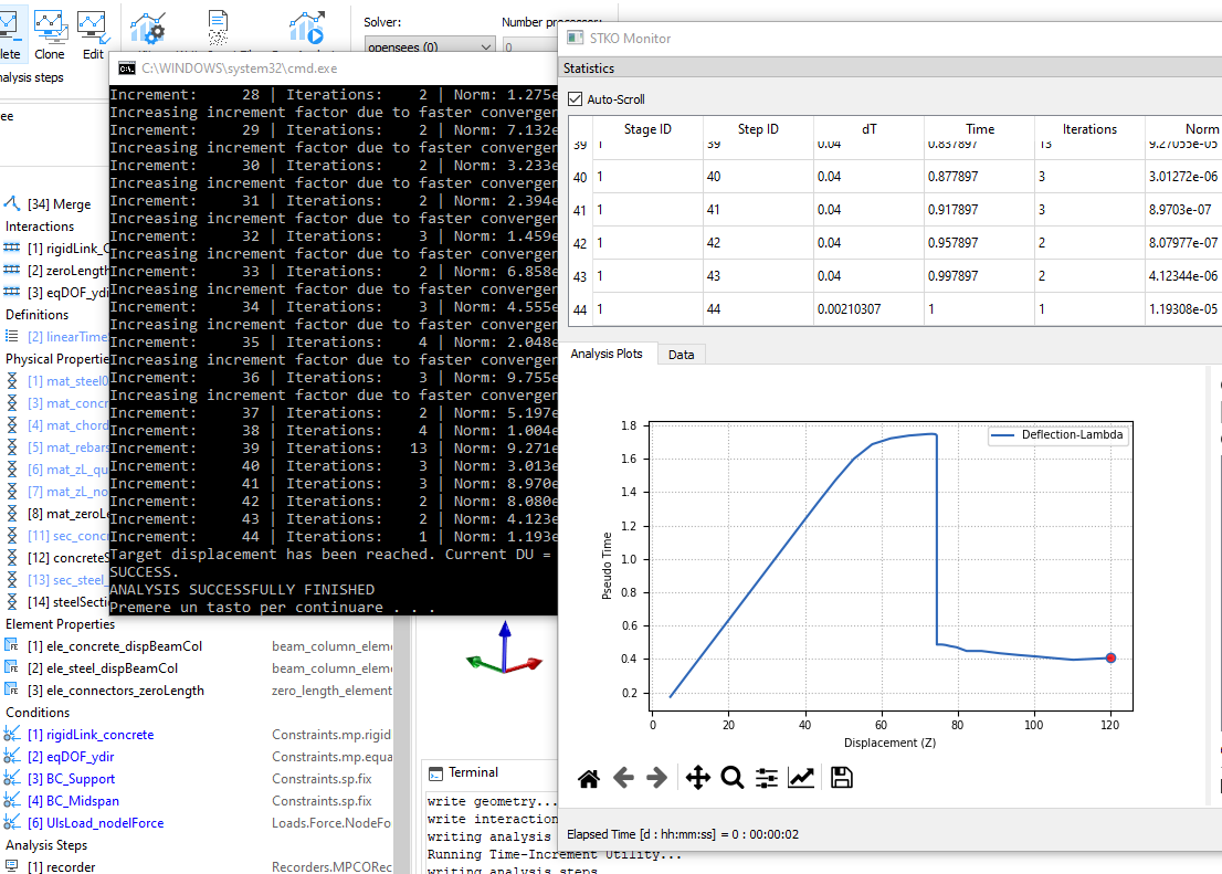

Post by STKO Team » Mon Aug 26, 2024 3:13 pm
Just use adaptive time step.
Your model is very brittle, so it will reduce the time step near the collapse:
