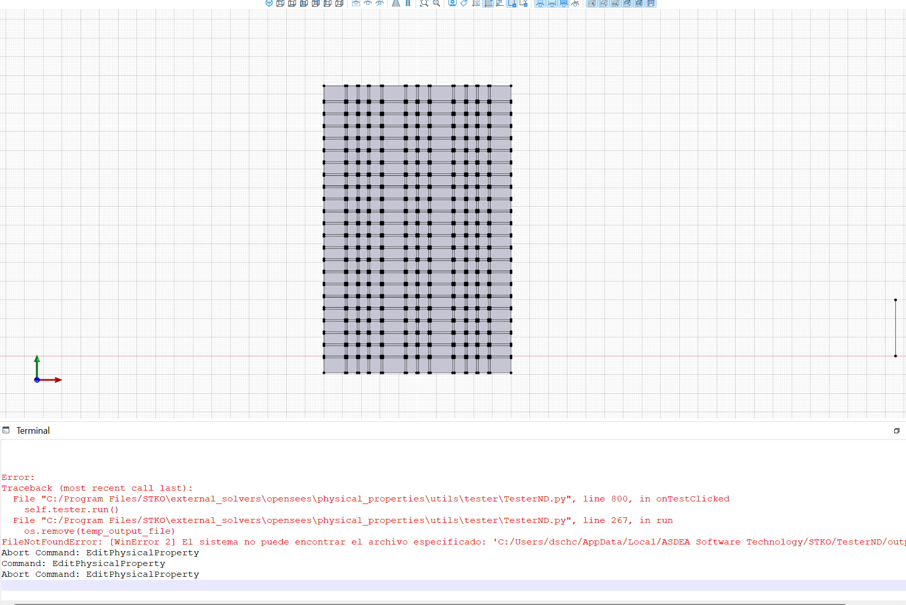

I get the following error message when I try to execute the test button in the material definition type DamageTC3D (masonry): Error:
Error:
Traceback (most recent call last):
File "C:/Program Files/STKO\external_solvers\opensees\physical_properties\utils\tester\TesterND.py", line 800, in onTestClicked
self.tester.run()
File "C:/Program Files/STKO\external_solvers\opensees\physical_properties\utils\tester\TesterND.py", line 267, in run
os.remove(temp_output_file)
FileNotFoundError: [WinError 2] El sistema no puede encontrar el archivo especificado: 'C:/Users/dschc/AppData/Local/ASDEA Software Technology/STKO/TesterND/output.txt'
attached error image
ERROR IN DamageTC3D test
- stko error.png (335.98 KiB) Viewed 1221 times
Re: ERROR IN DamageTC3D test
Hi, are you using the recent version of OpenSees? Also, you can check the writing permission to the folder (shown in the last line of the error message).
Please show the whole message you see in the terminal. Including any message from OpenSees.
What you see there is just an error coming from the fact that OpenSees failed in the analysis of the Tester
