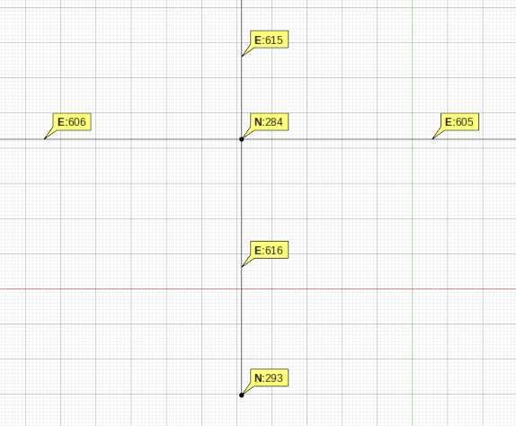

Thank you for providing a sample tcl script and additional resources. I am understanding generally how the script is working, but I think I may need more of an explanation on the numbering to apply this to my own model. I have tried several different combinations and nothing I have tried has worked. Can you elaborate on what you mean by "material ID for zero length element" and "integer tag". I apologize if this is obvious, but I am very new at writing my own tcl scripts and they do not make much sense to me yet.
For example, I have the following model. And I would like to analyze the plastic hinge rotations at each end of the column C2A. The mesh has labeled the column as element 616 connected to nodes 284 and 293. My drawings refer to this column as C2A, so everything in the model corresponds to labeling "C2A" I have all of the following properties corresponding to C2A listed here with their tag, the name I gave them, and the detailed property name:

I have had my model reviewed and I am sure that it is good and that the model itself does not need further revision, I would just like assistance with the script if you are able. Or, if my model is too large, do you have any smaller examples with a plastic hinge recorder you would be willing to share?

Re: Creating text files for rotations about the x-direction
Hi, Thank you writing to us.

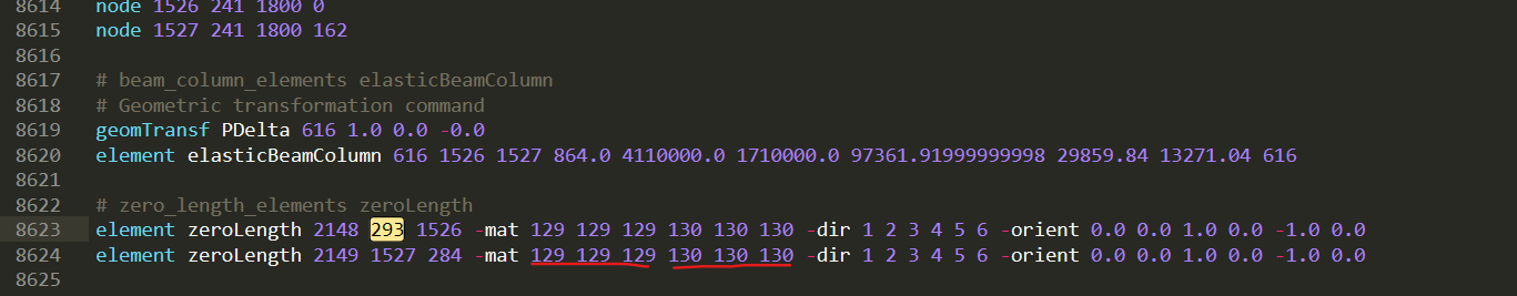

To identify the zeroLength element tag, you need to look at "Element.tcl" file after STKO writes all input files (can be found at the same location of SCD file). For example, C2A column that you mentioned is assigned with zeroLength elements at its ends by STKO (creating extra nodes). Please see the figure attached below. The hingedBeam has elastic core (assigned with elasticBeamColumn element, ID=616) and two zeroLength elements (ID=2148, 2149) at ends.
In the recorder script shared previously, material means the DOFs along which the uniaxial material is assigned, hence you can use the following script for zeroLength element 2148 to record force (or moment) and displacement (or rotation):
recorder Element -file Force.out -time -ele 2148 material 4 stress
recorder Element -file Displacement.out -time -ele 2148 material 4 strain
The script above considers recording the response of zeroLength element 2148: After running analysis with this script , if you open Force.out file, you can find the pesudo-time in the first column and the force along 4 DOF in the second column. In the same way, you can see the deformation in Displacement.out file. Please note "4" denotes the DOF along which the uniaxial material is assgined. Similar to this, if you want to record force and deformation along 5 DOF, replace 4 with 5 in the script above.
I would also suggest a different script given below for recording the force and displacement response along all DOFs. Now, consider recording the response of zeroLength element 2148: After running analysis with this script , if you open Force.out file, you can find the pesudo-time in the first column and the forces along 1, 2, 3, 4, 5, 6 DOFS in the remaining columns. In the same way, you can see the deformation in Displacement.out file. I think you are interested in recording ModifiedIMK model along 4, 5, 6 DOFS, so refer to columns 5, 6, and 7 in those files.
recorder Element -file Force.out -time -ele 2148 force
recorder Element -file Displacement.out -time -ele 2148 deformation
