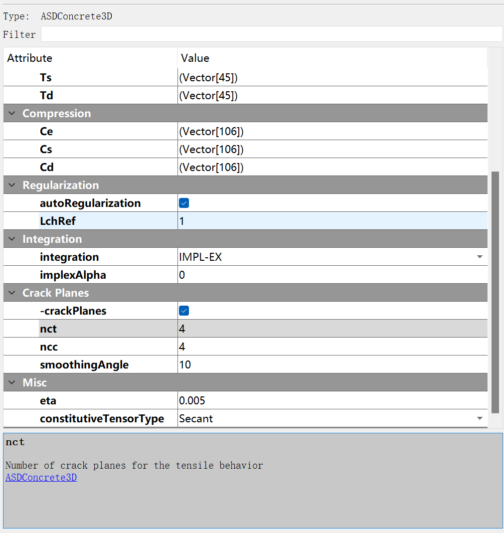

Dear STKO team, are there any recommended values for nct, ncc and smoothingAngle when I try to model masonry structures by macroscopic modeling method.
Re: the recommended values for nct, ncc and smoothingAngle when use ASDconcrete to model masonry material.
Post by STKO Team » Wed Jan 17, 2024 3:56 pm
You can use the default ones.
It's only relevant for cyclic loading
