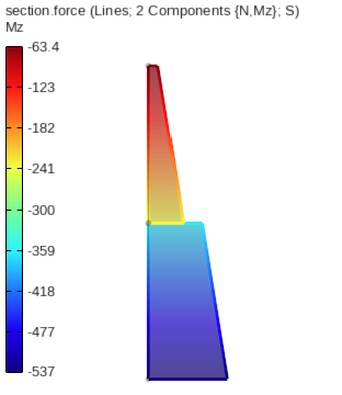

When I visulize the result in STKO post-processor, the Gausspoint plot shows the Gauss points are located at beam ends, see the screenshot attached.
And when I plot the beam bending moment diagram, you can see the bending moment is dis-continuous between two elements. I output the bending moments at end of beam element and noticed they equal to the moment value at Gauss points. However, as I mentioned above, the Gauss point for displacement-based element should be inside the element.
Any comments are welcomed

Indeed, you are correct in noting that the integration points are displayed at the ends of the beam. In the current scenario, STKO relies on OpenSees to gather information about integration points. However, due to the absence of standardized rules for outputting the location of integration points in OpenSees, STKO assumes that they are situated at the ends of the beam. We acknowledge this challenge and are actively working on identifying a workaround. Subsequently, this workaround will be incorporated in future releases of the STKO software. Thank you.
