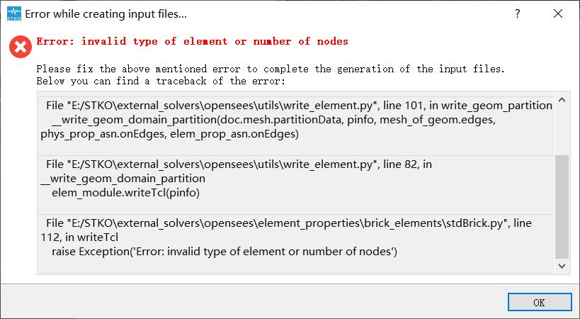

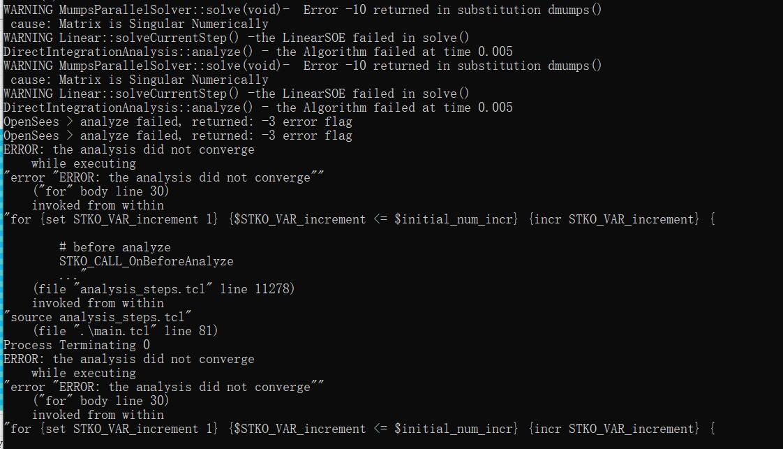

I try to build a hill with Solids-Structured-Hexa-Linear mesh and stdBrick element.
However, when I run the analysis, it shows something wrong and I hope anyone can help me.
It shows that "Invalid type of elements or number of nodes".
At the same time, it also potentially has the problem that "Matrix is Singular Numerically".
Thanks a lot!

Re: Invalid type of elements or number of nodes
Sorry for wasting everyone's time.
When this problem appears, there may be two reasons, which are the mismatch between element and mesh, and the wrong building of the geometry.
Here, I used the stdbrick element and meshed the model with structured hexa. I checked this and there was no wrong.
The only possible is the geometry so I rebuild my model. Finally, it works.
I hope my mistake can help someone.
Good luck, everyone!

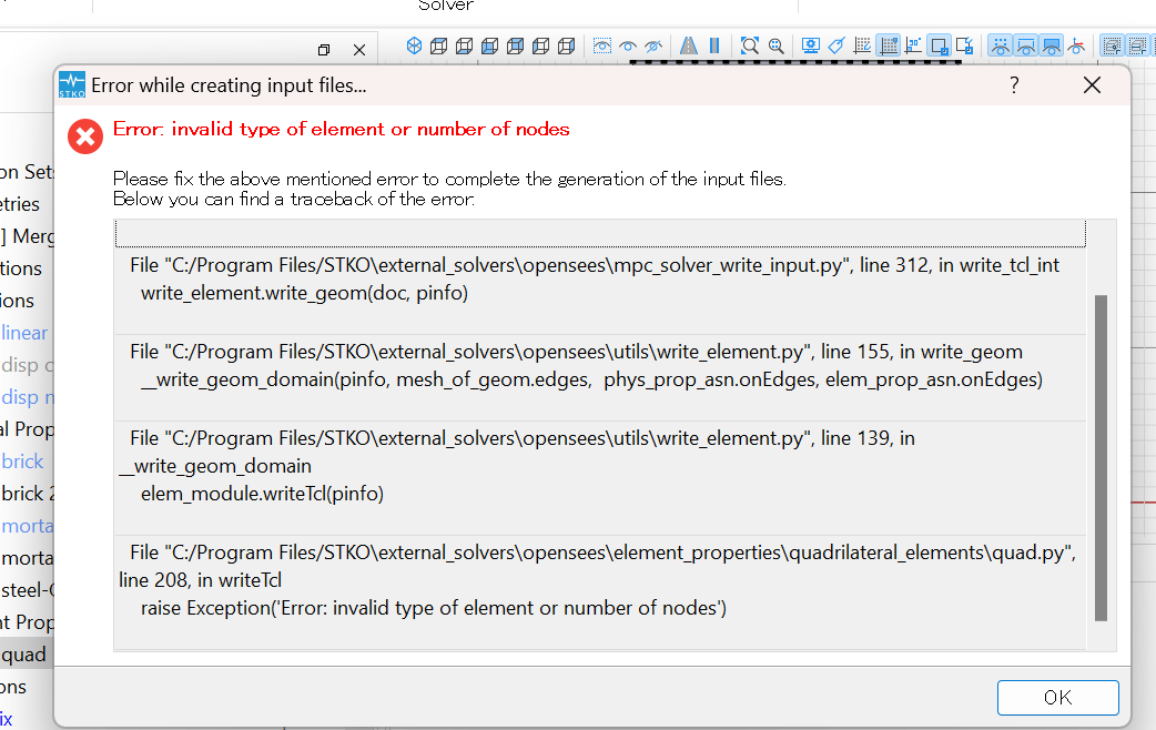

Thank you for your response. I modeled the prism again. Now I faced with the error in the screen shot. Please guide me with the solution.
I really appreciate your kind reply.
- Screenshot 2024-05-01 121136.png (146.14 KiB) Viewed 3057 times

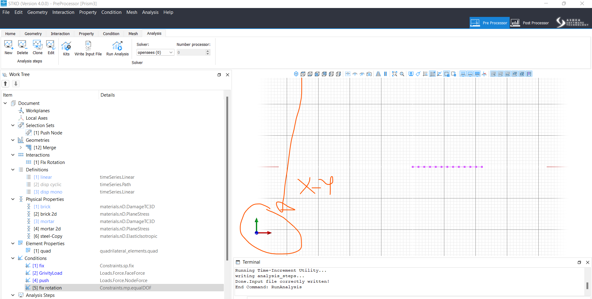

Hi, I noticed you have still not modelled the structure in the XY plane. The model geometry should be drawn using the XY plane, as shown in the attached figure.
- invalidEle.png (159.75 KiB) Viewed 3033 times
