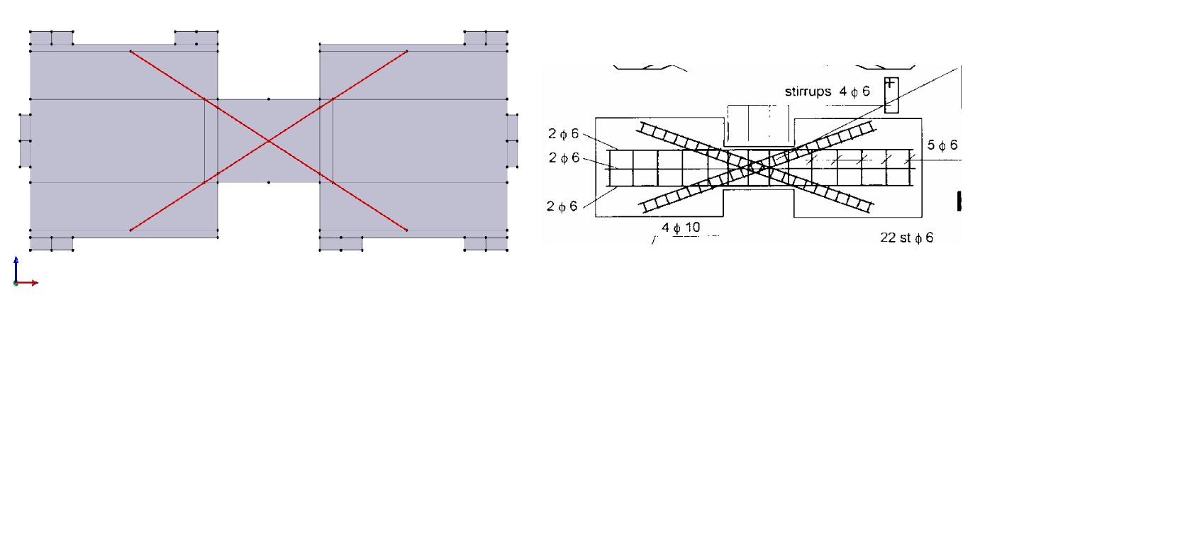

before jumping to model the coupled shear walls, i am starting with model verification and validation by matching STKO result with experimental results. so i have chosen two specimens of coupling beams tested by Galano and vignoli as shown in the attached figure.
i need guidance whether to model the specimens as 3D solid element or as a shell element.
also for the diagonal reinforcements and the stirrups around them which approach do you recommend to use for modelling in STKO?

i failed to match STKO results with experiment so i decided to try modelling the coupling beam with 2D shell element instead of 3D solid element. i have been watching the tutorials on you website and YouTube and in all shear walls the 2d shell element models were modelled using smeered layers of concrete and rebars. i am afraid the smeared model approach won't give accurate results specially that I have diagonal reinforcements with stirrups.
the modelling approach that i am planning to consider is to model the shell elements in triangular and trapezoidal shapes to have the diagonal reinforcement edges as boundary elements and model the conventional reinforcements as smeared layers
i am not sure if this is the best way to have accurate results or maybe you can suggest a better way to model the reinforcements such that i will be having accurate results.

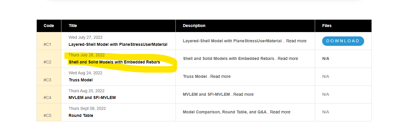

Actually, now you can "embed" rebars (made with beam elements) into solids or shells.
At the bottom of our webinar page there is a short course on RC shear walls (https://asdea.eu/software/advanced-e-learning-courses/):
