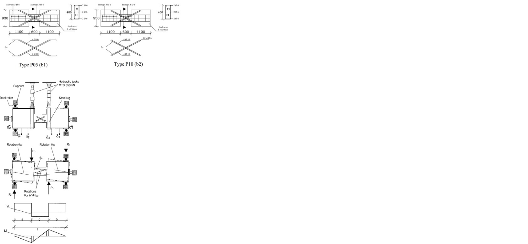

i have decided to utilize STKO as FE software to carry out my thesis study titled "Investigation of seismic performance
for ductile coupled shear walls". i have some questions related to modelling the shear walls and coupling beam in between.
before jumping to model the coupled shear walls, i am starting with model verification and validation by matching STKO result with experimental results. so i have chosen two specimens of coupling beams tested by Galano and vignoli as shown in the attached figure.
i need guidance whether to model the specimens as 3D solid element or as a shell element.
also for the diagonal reinforcements and the stirrups around them which approach do you recommend to use for modelling in STKO?

If you want to save time you can model it with shells.
Regarding the reinforcements, you can choose to model them as equivalent smeared layers, or physically embed them into the shell (The second option can be more accurate)
Check our webinars on RC shear walls.
Then you can choose which approach to follow based on how large are your models, and based on the level of accuracy you want.
For example, if you just need to simulate the detailed response of a specimen, you can go with embedding rebars as fiber-beam elements inside the shell.
If instead you need to model whole buildings you may want to use the simplified (smeared) apporach

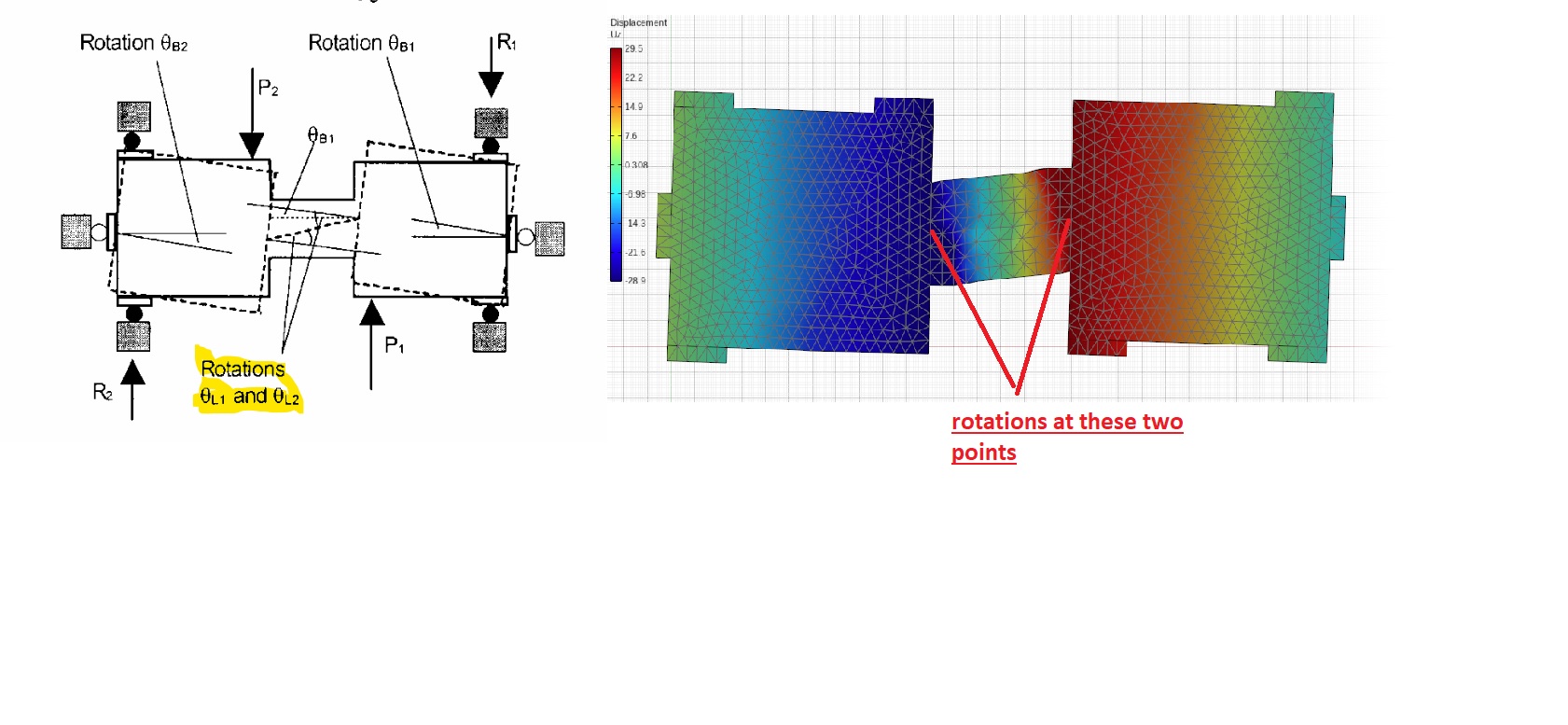

i have questions related to data extraction in the post processor:
-i am trying to extract the rotation of the beam at certain points (refer to attached picture). while selecting the points and extracting the data chart, rotation will come as zeros throughout the steps. please provide the methodology to extract the rotation at the points shown in figure.
- how to extract the shear force in the beam throughout the steps?
i need to plot the rotation Vs shear force in the beam to compare the results with experiment.

- You cannot see Rotations directly in the DOF of solids because they don't have rotation DOFs. You need to do your math.
Compute the delta vertical displacements and use the length to compute the (infinitesimal) rotation - you can get shear force from the reactions
