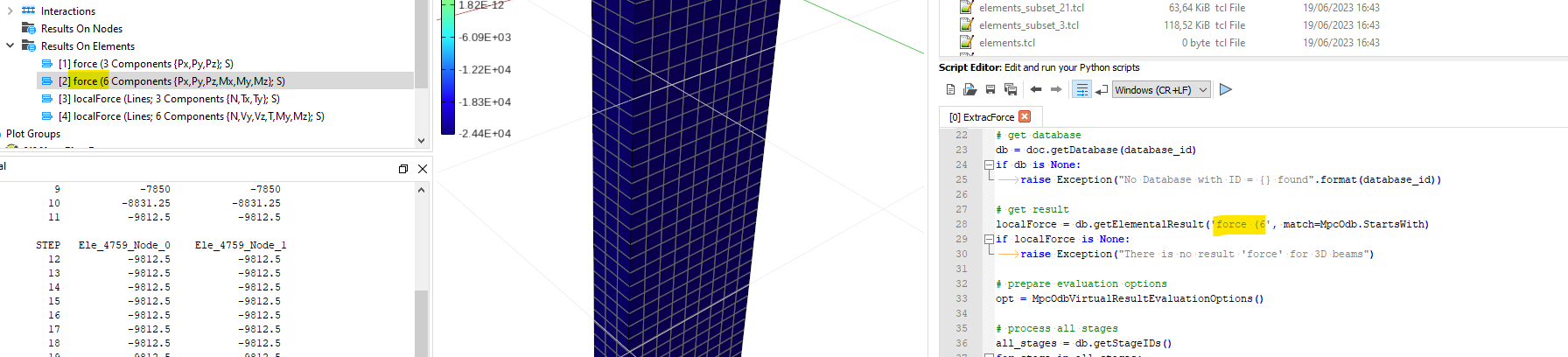

I have encountered a problem and have to seek your help in extracting the internal forces of the structure, when using the local coordinate system, I can extract the internal forces of the structure better, but when I use the global coordinate system, I cannot extract the global forces properly, in the analysis, we prefer to use the global forces, can you help me to modify the code?

It's because you were using the wrong name for the result... The name you put in your Python code should match the name in the MPCO database:

Thanks for your help, I have solved it. In the meantime, I would like to know when the new version of STKO software 3.4.1 or 3.5 will be released?
