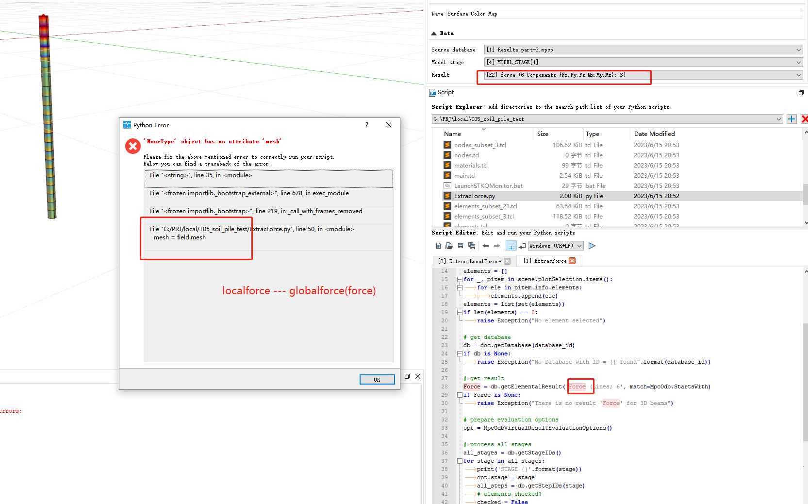

Dear STKO team:
I have encountered a problem and have to seek your help in extracting the internal forces of the structure, when using the local coordinate system, I can extract the internal forces of the structure better, but when I use the global coordinate system, I cannot extract the global forces properly, in the analysis, we prefer to use the global forces, can you help me to modify the code?

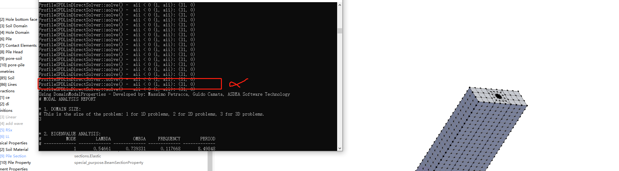

In addition, I have come across a new question, how can I get the eigenvalue and response spectrum analyses of a saturated sand site? Can you give me some suggestions?

Re: model flash
The 2x2gaodi.zip file seems corrupted. We can't do anything about that.
Re: model flash
It's because you were using the wrong name for the result... The name you put in your Python code should match the name in the MPCO database:
Re: model flash
Thanks for your help, I have solved it. In the meantime, I would like to know when the new version of STKO software 3.4.1 or 3.5 will be released?

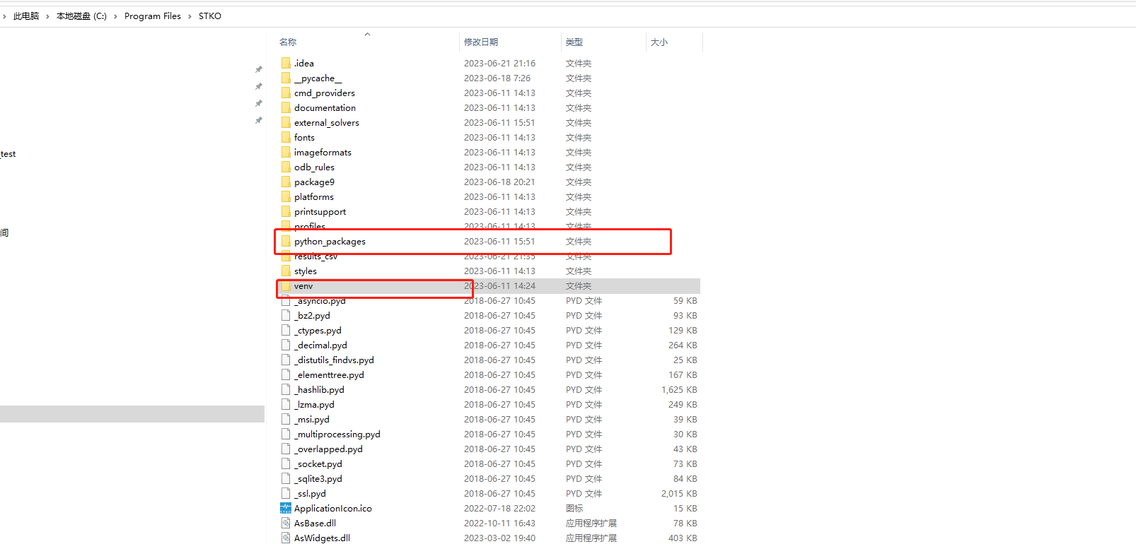

Dear STKO Team:
Can I know how to install third-party libraries under the STKO folder path "C:\Program Files\STKO"? For example, I want to use pandas, PySide6, however, I have tried some methods, such as creating a new virtual environment "C:\Program Files\STKO\venv", but pandas and other third-party libraries are not working properly

Re: model flash
You can simply install those packages in your regular python environment.
Then copy them from your site-packages folder to the python_packages in STKO.
Just make sure to use compatible versions.
For example, we are already using PySide2 (for Qt 5.12), so probably PySide6 will conflict with it
Re: model flash
Thanks for your suggestion, I have tried it and it is a viable solution.
Re: model flash
You're welcome. In future version we will try to provide an STKO pip command
