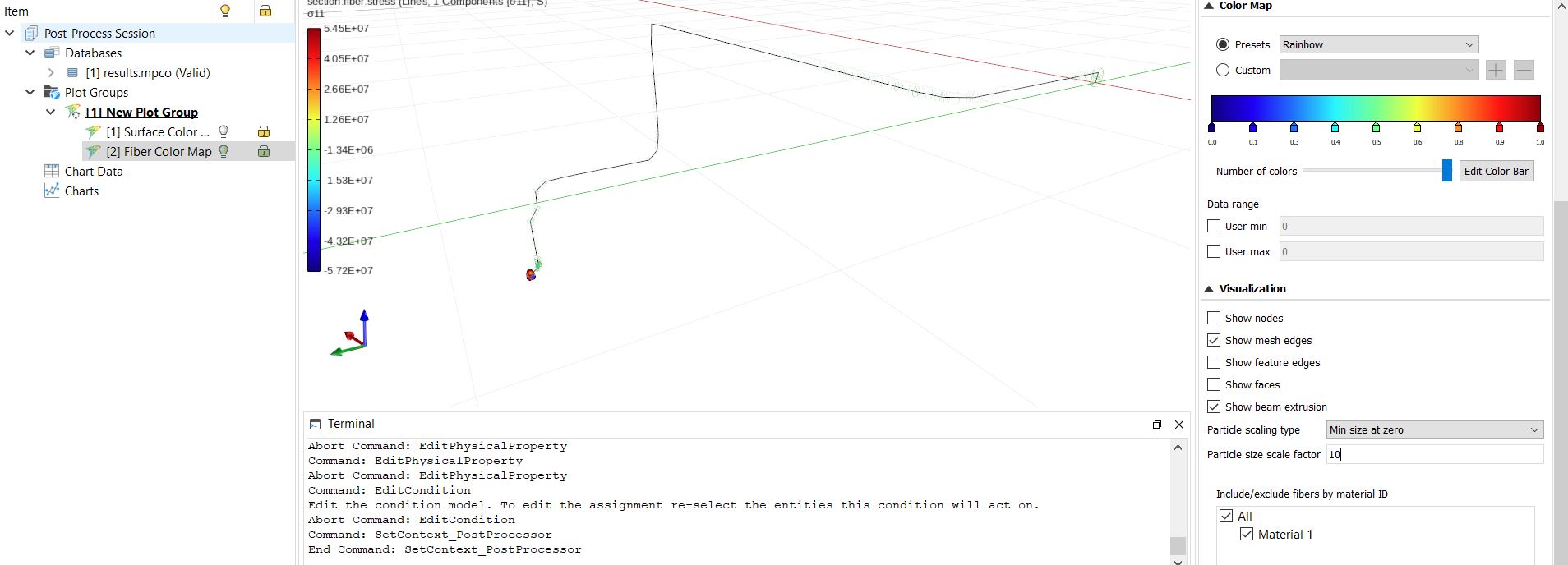

Hello STKO Team,
I am trying to model a piping system and trying to visualize the portions of the pipe which would fail first or lets say the potions with the most stress. The stresses are as a result of Gravity Analysis and Time History Analysis.
For the Gravity Analysis, i have input the masses as node forces(Since i cannot run gravity analysis with giving masses as node forces) and for the time history analysis i have input the masses as line masses.
I have also length interactions, Zero length elements for modelling the spring under the supports. The spring behavior is expected in only lets say global z direction and for the other two, i used equal dof condition.
I have the following questions.
> Is it ok to specify masses via both node forces and line masses. I assumed that the gravity analysis will only take the masses( specified as node forces) and TH Analysis will only take the line masses automatically. Am i correct for this assumption?

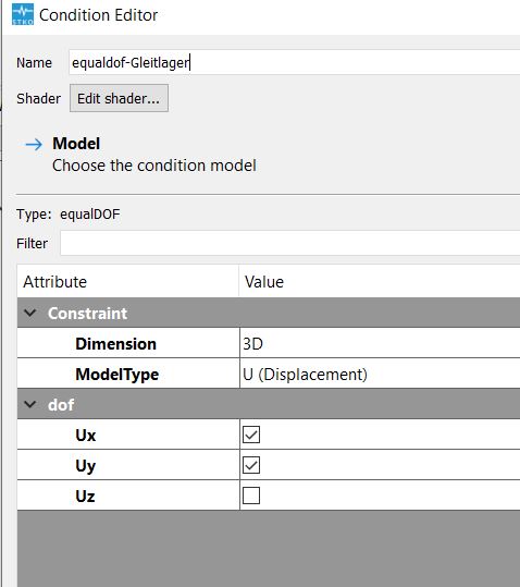

> While defining the ZL Physical property we have to select among dirn 1, 2 and 3(3d, only displacement), whereas for the definition of equal dofs we see ux, uy and uz. My question is are these are local axes or global axes? I remember vaguely seeing it in one of your webinars but i cannot find it again. > The stresses values are not in line with the expected values. Could you possibly please check the model? I do not know what i am doing wrong.
> for checking the section forces like N, My, Mz and T, i can see it via the surface color map plot as well as the gauss point plot. Are they both the same ?
> Is it possible to view the max stress, max reaction forces etc. for a Time History analysis without having to see time steps one by one? Yes it should be point of max acceleration but still i am curious if we can just find the max.

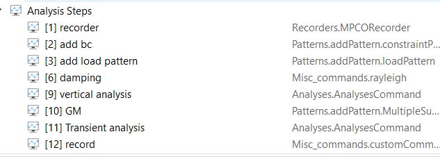

> I used the following analysis steps. Gravity analysis followed by TH analysis. My question is should i be using wipe analysis option after the Gravity analysis or not, i want to see the cumulative effect of both of them? I compared the displacements and reaction forces in all 3 directions, with and without the wipe analysis option being selected, but the results were same. It should not be this, right?

By default, they use the global axes. Unless you assign a custom Local Axes to the interaction> While defining the ZL Physical property we have to select among dirn 1, 2 and 3(3d, only displacement), whereas for the definition of equal dofs we see ux, uy and uz. My question is are these are local axes or global axes? I remember vaguely seeing it in one of your webinars but i cannot find it again.

'' Gravity analysis followed by TH analysis. My question is should i be using wipe analysis option after the Gravity analysis or not, i want to see the cumulative effect of both of them? I compared the displacements and reaction forces in all 3 directions, with and without the wipe analysis option being selected, but the results were same. It should not be this, right? ''

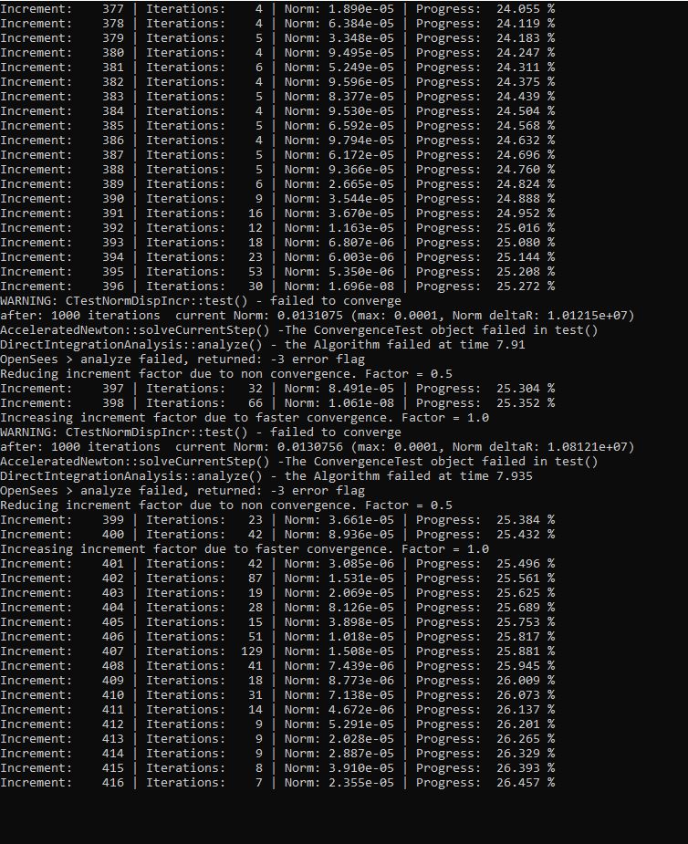

> For this model if i apply the Ground Motion in x to the original supports and few more supports , during the analysis steps, the following error is showing up. As i understand it, it is because of the Toi value set in Norm displacement increment test. However the algorithm, i guess tries to reduce the increment factor, in order to fulfill the condition. But the analysis keeps going on and completes.
Does this mean that my model results are correct or wrong because of failure at this time step, beacuse i can see an error flag is also being generated? I am attaching the updated model with GM in x dirn.

You are probably confusing "wipeAnalysis" with the "loadConstant". To keep loads from gravity analysis you selected "loadConstant" in the first analysis and you reset pseudotime to 0. Try to remove this and you will see the difference. Anyway now it is set up as you want.
You are using adaptive time step so when it is difficult to converge it is reducing the increment. It doesn't mean that your results are wrong.

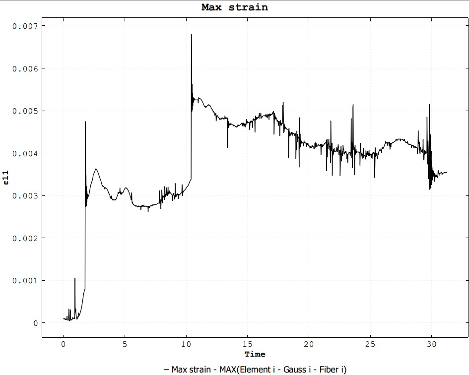

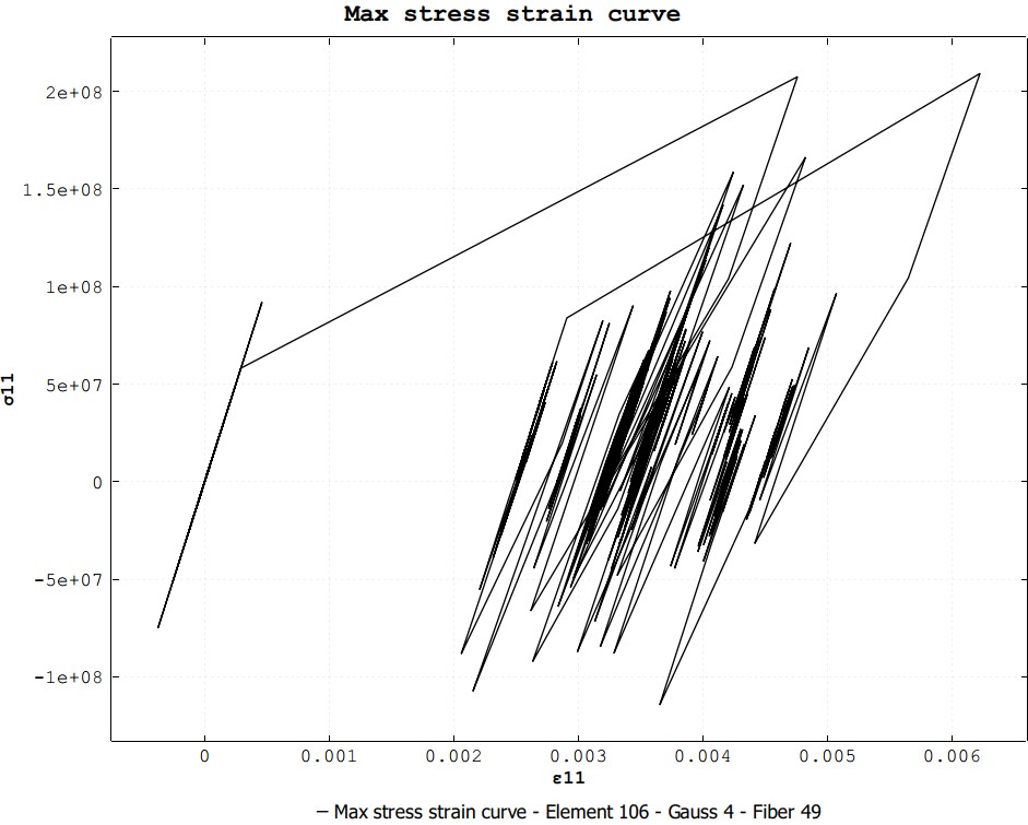

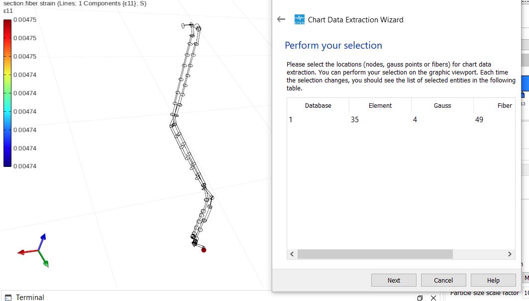

Hello, I have attached the model and also the location of the element exhibiting this behavior.
I have also attached the Max strain curve which which i found the time where it was showing peaks (first peak=1.78s). I then searched the element having this behavior at 1.78 sec and proceeded to see its max stress strain curve which is also attached.

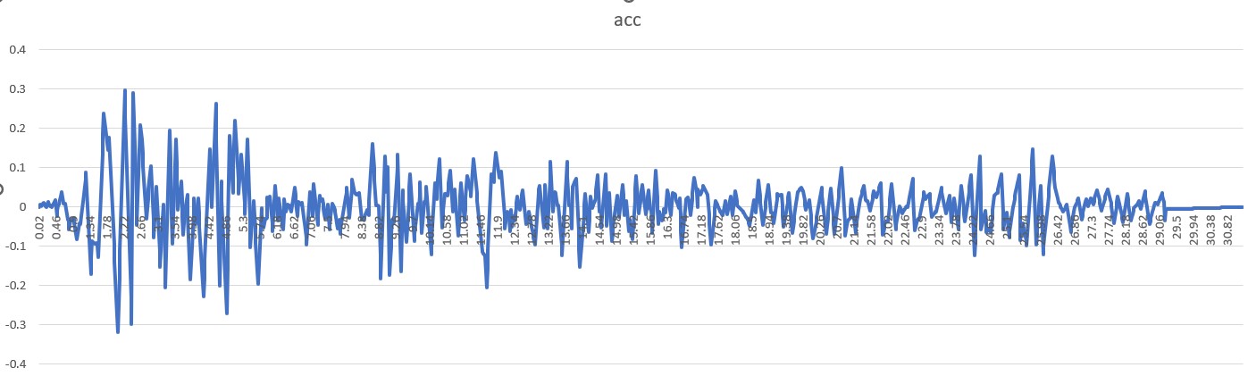

I have one more question though. The Time history i used here is El Centro Earthquake . It has its absolute maximum acceleration at 2.06s with an absolute value of 0.31882g. Should the structure not display the max response lets say in terms of strain at this time step? If i change the factor of the time history the peaks in the max strain curve shift left or right. But the absolute value will still remain at 2.06 s. In my understanding the structure should still exhibit its max response at this time step or am i missing something here?
Your help is much appreciated.

The stress-strain diagram seems strange just because you are sampling a few points. Increase the number of increments in your analysis and the output will be smoother.
Also, in the Rayleigh damping, I would use Kinit and not Kcurr. If you make the damping dependent on the current tangent stiffness, you may have numerical issues.
Finally, you can also try to use a transient integrator with numerical damping such as the HHT.
Last, but not least, try to understand why you have strain concentration in that end. If it's physical it's ok. Otherwise you have to make sure it's not a problem of coarse mesh.
