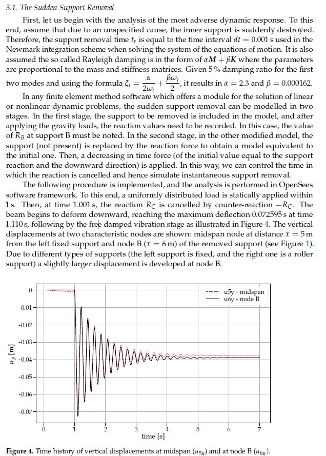

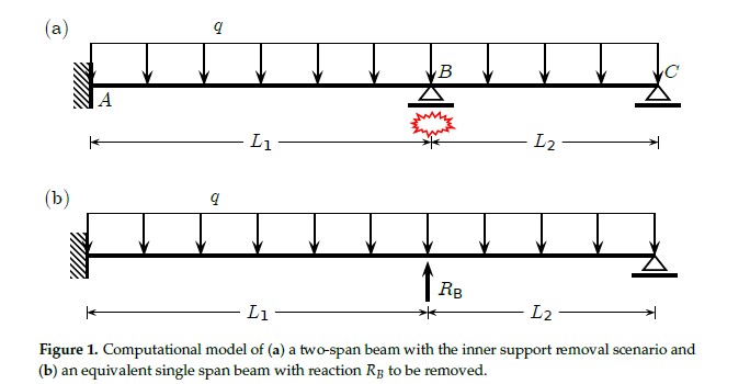

I want to do an analysis of the removal of the support over time and get the results as in the example shown.
removing 1.001 s.jpg (231.41 KiB) Viewed 3181 times
I have put 2 files under the post:
1) I used the Force From Reaction command and made the calculation according to the topic on the forum: viewtopic.php?f=33&t=1752
2) In the place of removing the support, I inserted the value of the previously calculated reaction and counterreaction.
In this model I want to perform the procedure described in the picture:

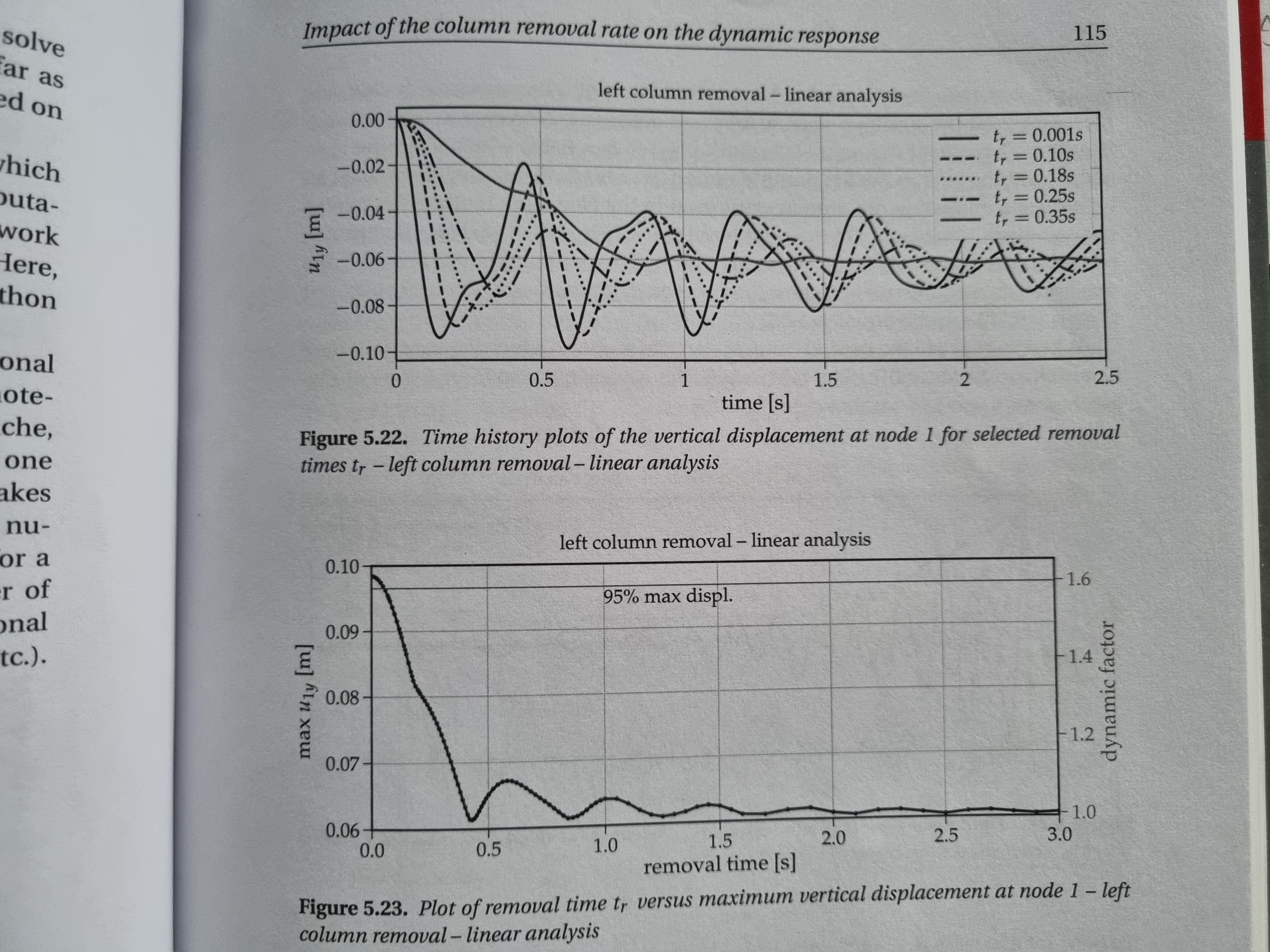

My main goal is model 2 and, first of all, to perform analyses depending on the support removal time (tr). For example, what will be the displacement in support B for tr = 0.10 s and what for tr = 0.18 s as in the attached picture. Am I able in STKO to carry out simultaneous analysis of carrying out an analysis of the removal of the column for different tr? So as to obtain on one diagram displacements depending on different tr (figure 5.22)
different tr.jpg (4.15 MiB) Viewed 3181 times
I will be very grateful for your help

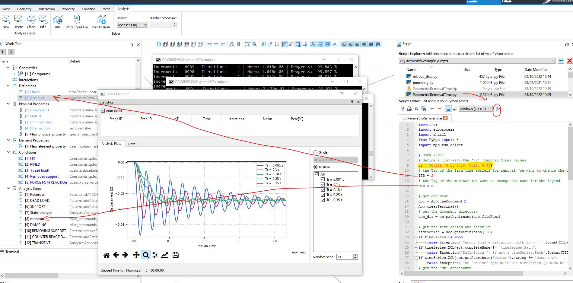

Here's a python script that runs your analysis parametrically:
ParametricRemovalTime.zip
(1.21 KiB) Downloaded 191 times
Here's what you get:

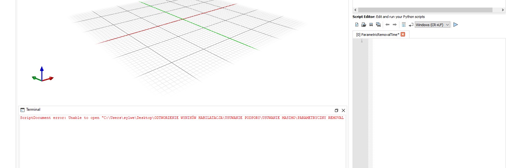

Thank you very much. This will save me a lot of time. I have a small problem with the script editor. When I open the PY. file in STKO I get an empty script. On the other hand, if I run the analysis everything works, but I can't edit the script because I can't see it. Is this a STKO bug?
Re: FORCE FROM REACTION VS COUNTER REACTIONS. Control of support removal time.
Post by STKO Team » Wed Nov 02, 2022 9:27 am
Don't put scripts in folders with special characters. In general, do not use folders or file names with special characters in STKO. They can give problems.
(from the image I can see a "O" with an acute accent)

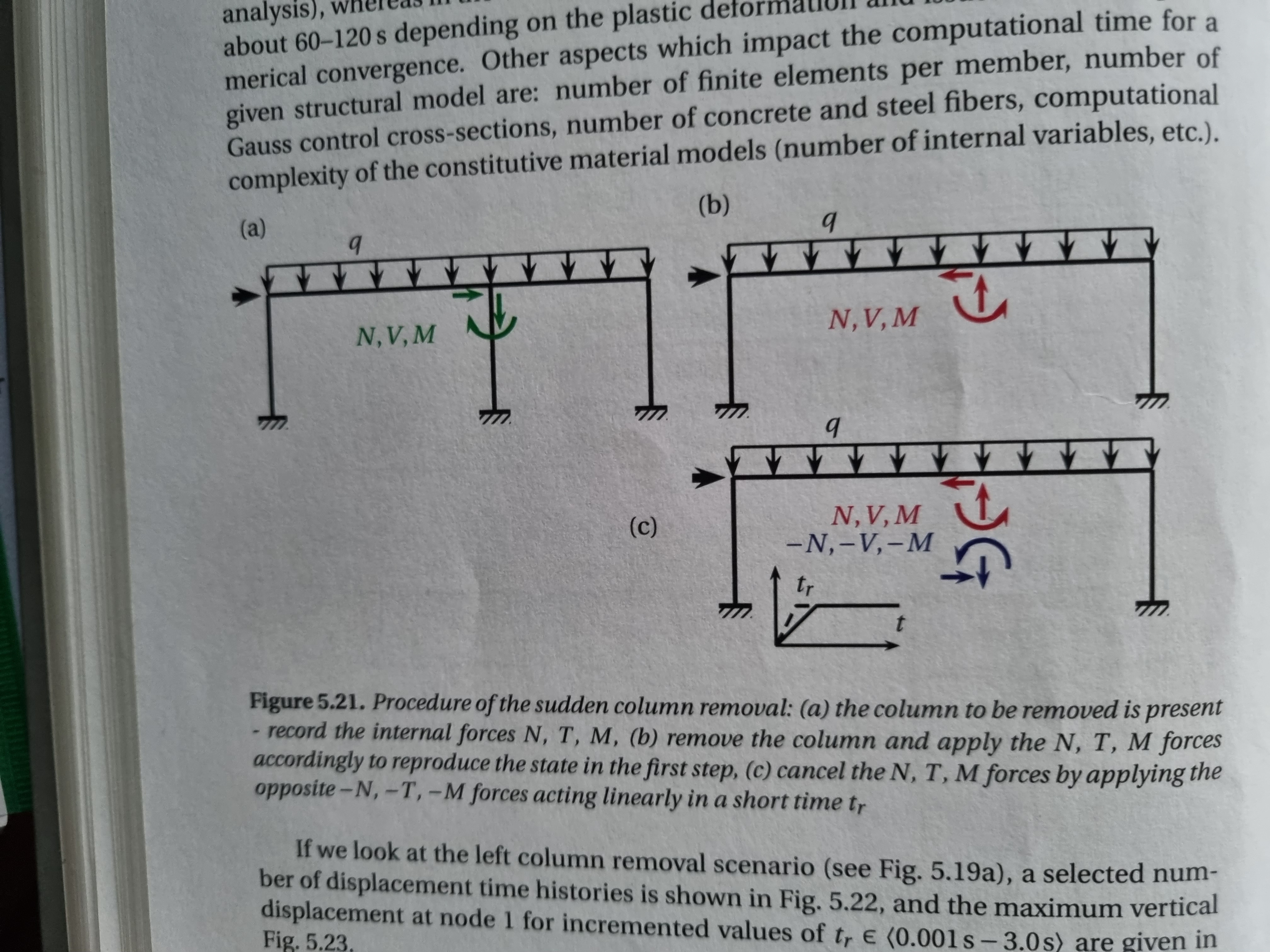

Dear STKO,
Thanks to your help, I have carried out the above calculations for a reinforced concrete slab in which I am removing the corner column.
I wanted to ask for your help in slightly modifying my model.
In the above model I would like to remove another column (any column), with the same force from reaction procedure.
Specifically, I would like to achieve this effect:
1. perform a static analysis
2. remove the first column for a specific tr (time removal)
3. remove the second column at a time, e.g. 2 s after starting to remove the first column.
I don't know how to model the effect of removing the second column after the selected time to start removing the first column.
Do I need to create a new load path for procedure 3? Do I need to create a 3rd dynamic analysis command?
Best regards
