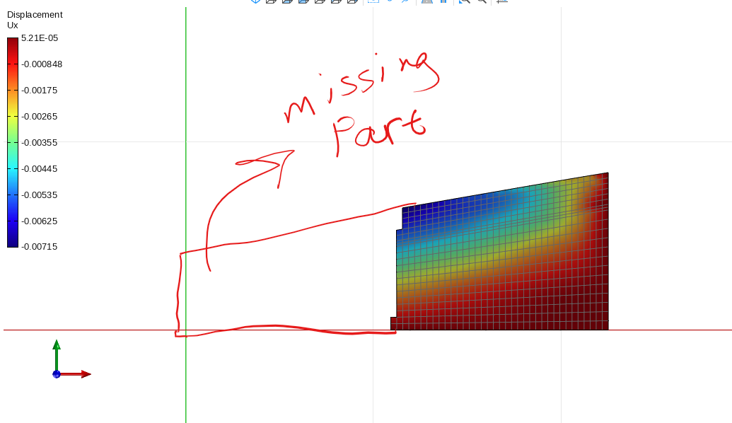

I am facing a problem postprocessing the MPCO recorder container after solving a model using OpenseesSP. The output MPCO files are separated into many files according to the running solution processes. When I post-process the model outputs, after finishing the simualtion phase, I find only a portion of the model is plotted, and the other parts are not plotted. Why did this issue appear, and how to solve it or combine the MPCO hdf5 files into only one file to overcome this issue?

- An output contour of two processes model solution
- Screenshot 2022-09-30 053415.png (130.39 KiB) Viewed 3689 times

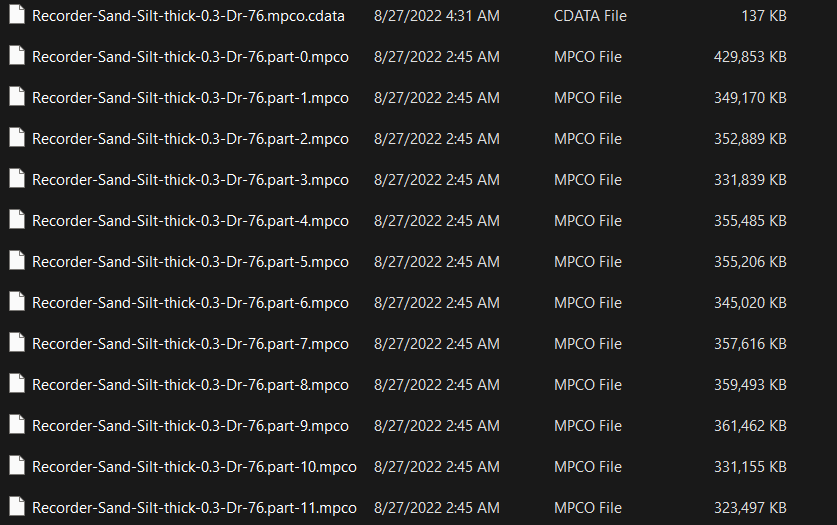

You should have multiple mpco files, with the same name, and a postfix like this:
Can you confirm?

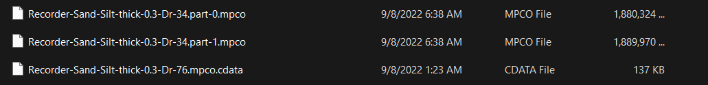

I have only one file with the extension "mpco.data" and many files with the extension ".mpco". I do not know why only one file with "mpco.data" is available; how to solve this issue?

If you are using OpenSeeSP it's normal that you have only 1 CDATA file.I have only one file with the extension "mpco.data" and many files with the extension ".mpco"
The error is elsewhere.
When you load one of the MPCO partitioned databases (part-1, part-2, etc..) STKO will try to load all of them. If it finds and error (incompatibility between the partitioned databases) it will write a (RED) error message in the Terminal.
Can you show it? (do a screenshot or copy-paste it here)
Note: sometimes this error happens when you first run OpenSeesSP with N processors. Then you re-run it with M < N processors.
The last (N-M) mpco files are old, and will be incompatible with the new M ones... make sure this is not the case
