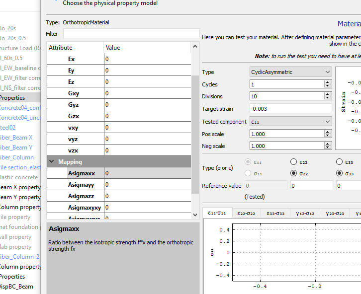

How to learn the meaning of parameter settings of orthotropicmaterial in stko?
Re: about orthotropicmaterial
The description for each attribute is given in the bottom box once you click on it:
- ortho.png (52.92 KiB) Viewed 9459 times

First, you have to set the orthotropic elasticity constants.
If you are not familiar with the Hook's Law for orthotropic material have a look here.
At the bottom you will find the stiffness of an orthotropic material. You just have to make sure that, with the input parameter you use, the Delta is > 0.
Then you have to set up the orthotropic strength coefficients.
Where, for example, AsigmaXX = Fxx_iso / Fxx_ortho
where Fxx_iso is the strength in X direction of the source isotropic material, and Fxx_ortho is the real strength in the same direction of the orthotropic material.
For example, assume you define a DamageTC3D which is isotropic, with the tensile strength Ft which is equal to the tensile strength of the orthotropic material in the X direction -> Ft = Fxx_ortho. Therefore, AsigmaXX = 1
Now immagine your orthotropic material, along the Y direction has a smaller strength, let's say Fyy_ortho = ft/2 -> AsigmaYY = Ft / Fyy_ortho = Ft / (Ft/2) = 2
