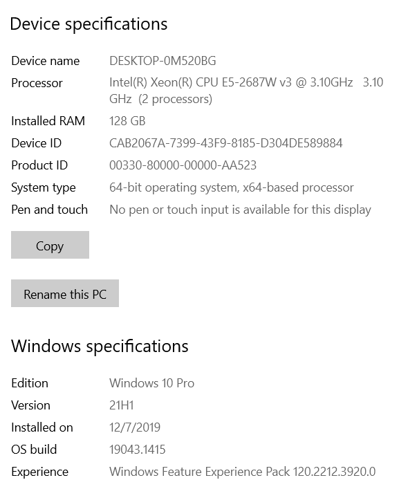

  • This is my computer properties
Screenshot 2022-01-04 144214.png (40.86 KiB) Viewed 7105 times

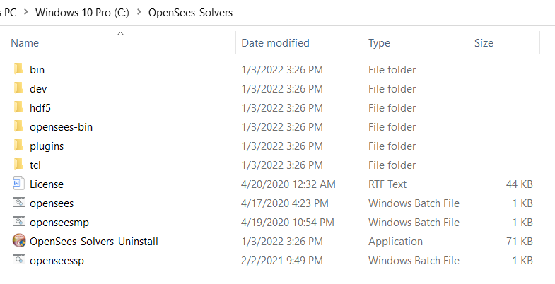

  • This is the OpenSees-solvers
Screenshot 2022-01-04 144411.png (36.71 KiB) Viewed 7105 times
    It works normally on other computers, but not on this one. Could you help me solve it? Thank you very much.
    Re: mpiexec.hydra.exe.stackdump
    Post by STKO Team » Tue Jan 04, 2022 9:31 am
    It should work on Windows 10.
    Make sure hydra_pmi_proxy.exe and mpiexec.hydra.exe (in C:\OpenSees-Solvers\bin) are allowed by the firewall.
    Make sure the antivirus is not blocking anything in C:\OpenSees-Solvers.
    If you are not sure, download again the OpenSees-Solver installer, disable the antivirus, and install it again
