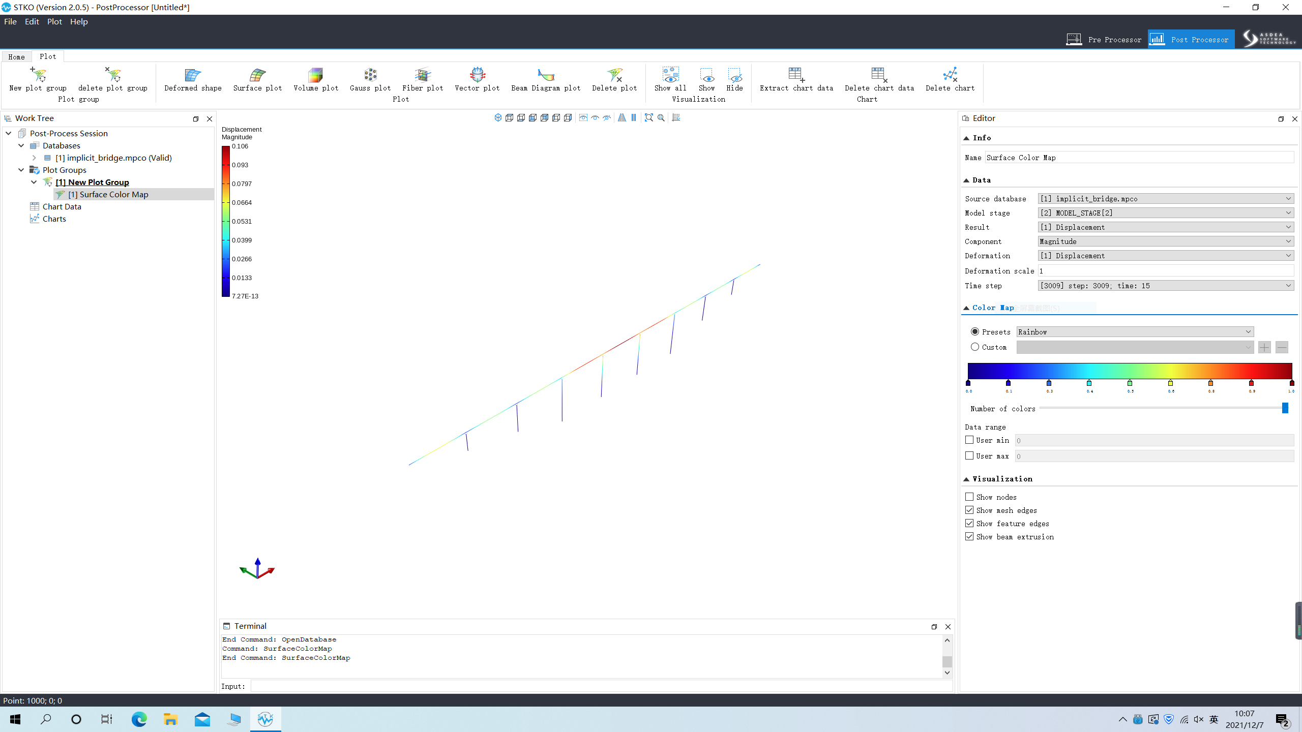

my results is always shows like the picture.
屏幕截图 2021-12-07 100832.png (1.76 MiB) Viewed 2785 times

Did you assign a section to your beams?
Please do send us your model :)

yes, I assigned the section to the beam.

Please post your model here, in a zip file, so we can have a look.

I found I didn't have a .mpco.cdata file, How can I creat this file? can you help me?
I need to solve this problem urgently.

Dear Spater,
our team has responded here: viewtopic.php?f=27&t=2156
