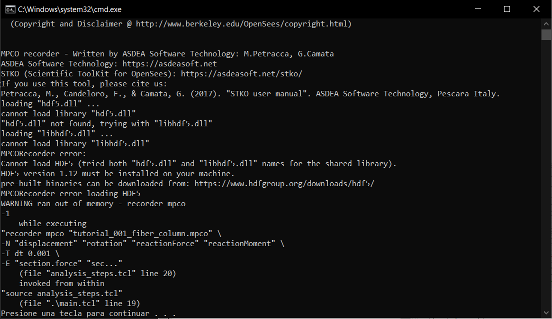

I'm starting to use the free version of STKO and when I tried to run an example which was done in one webinar I got these messages. What can I do in order to fix this issue?

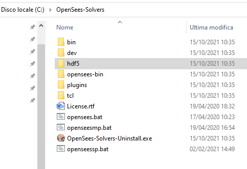

If you downloaded the version from prof. Tarque's website you should have an hdf5 folder in C:\OpenSees-Solvers.
Can you confirm that?

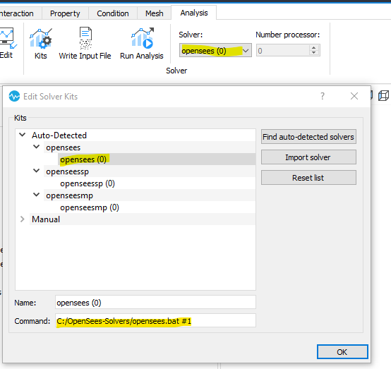

If you installed everything correctly, and the STKO Kits looks like this, you should have no issue:
Immagine 2021-11-15 101742.png (25.71 KiB) Viewed 3916 times
Make sure the kits are correctly using the .bat file and you selected the correct solver in the analsys tab

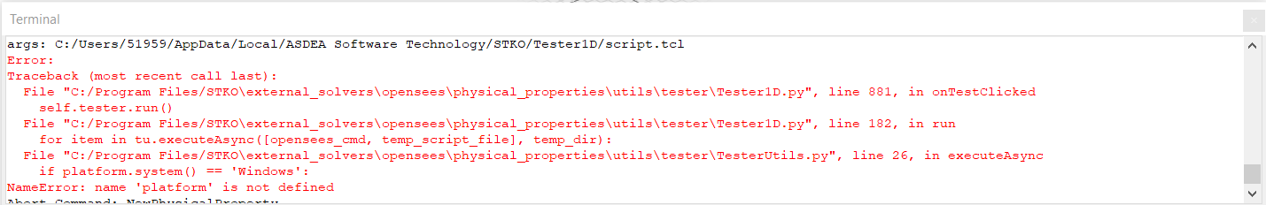

Sir, now I'm trying to do the test material and I get this error message, could you please help me with this issue? Is it related that I'm using the free version?
Re: hdf5.dll
Post by STKO Team » Tue Nov 16, 2021 2:36 pm
It was just a file missing in the initial uplodad of the 2.0.5 version.
Re-Download it and re-install it. It will be solved.

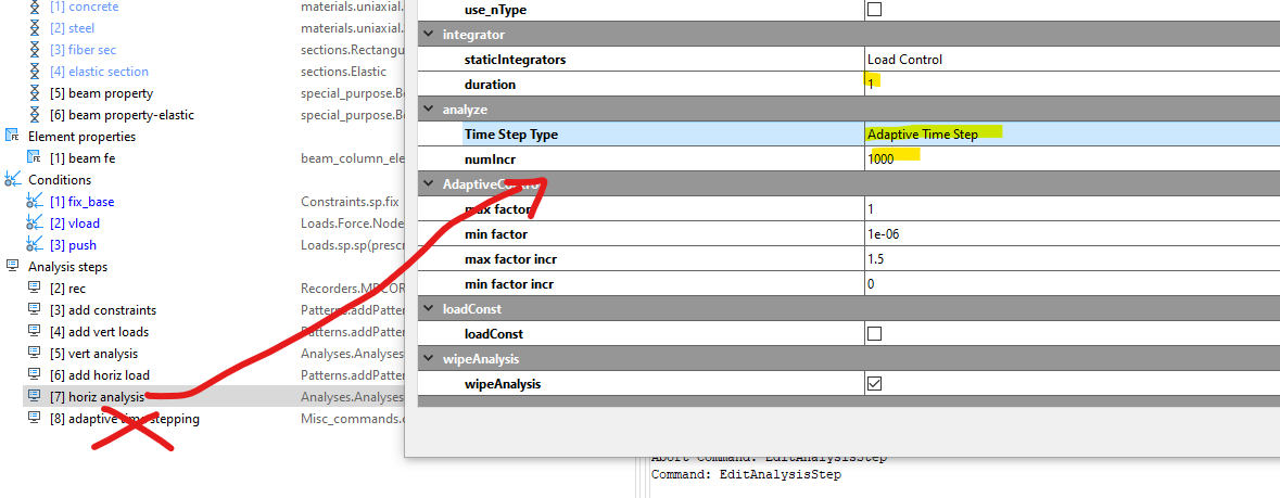

Regarding your error:
It was a very old webinar. At that time, the STKO analysis command did not have the "Adaptive Time Step" automation. So I tried to use a custom Tcl script to emulate that functionality. However, that script is incompatible with the new version. (If you want to make it work, you have to un-check the wipeAnalysis option of the previous analysis)
Don't worry anyway! in the new version we have a built-in Adaptive time step that makes the custom Tcl procedure useless:
Here's the modified file, I also added the monitor, a new feature that allows you to monitor the response of a point in real-time.

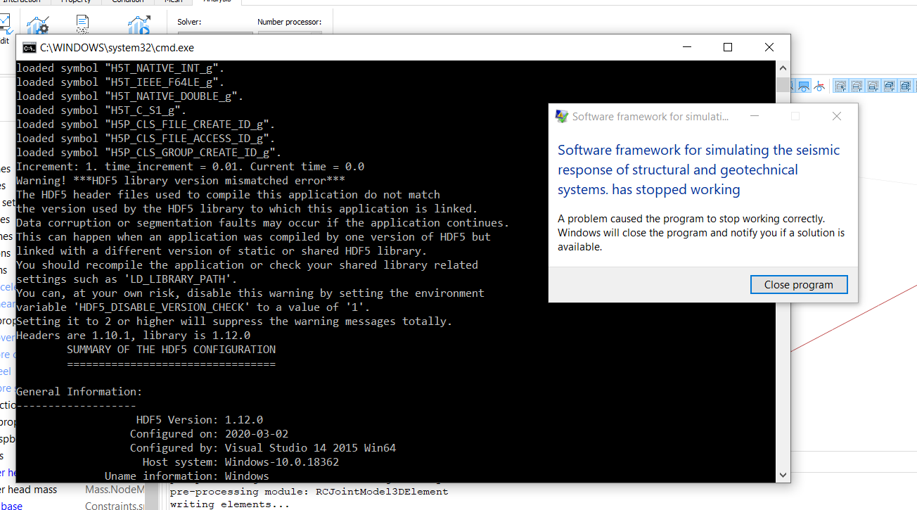

Hello team STKO!
I am getting the following error while running an analysis.

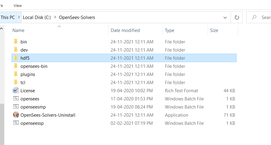

I'm receiving this error despite having the hdf5 folder in the OpenSees solver folder.
