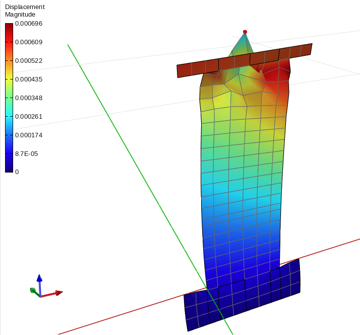

something really weird happens to your model, look:
I don't think you wanted to create that kind of boundary condition. I didn't get the use of the equalDOF you wanted to make. Usually, we create interactions where we want to assign specific internal boundary conditions between disjoint geometries, but you only have one geometry. If you want to make the top shell portion very rigid you can just assign an elastic rigid material. Try to review this and rerun your model.

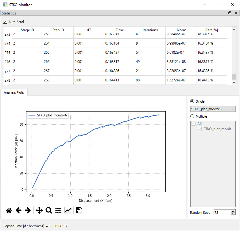

Here it the model I modified and the curve obtained.

I want to thank you for the fast reply and for taking your time and took a look to my model; now the model is running better than before, still with some convergence issues, now in the cyclic analysis, but, it is running!. I have already done your suggestions and the model is performing well.
